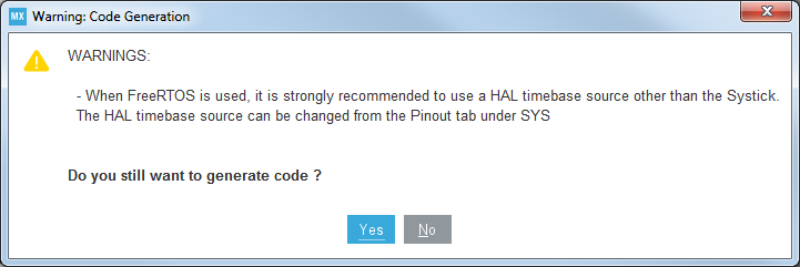

> About the Systick, is a high recommendation from STMCube to use a different timebase source
0690X00000AQoKNQA1.png"When RTOS is used, it is strongly recommended to use a HAL timebase source other than the Systick. The HAL timebase source can be changed from the Pinout tab under SYS"
Did you even read what it says? It recommends using other timer for HAL timebase, not for FreeRTOS. They do this because their flawed HAL junk uses timeouts in functions, which can be called from ISRs. Because of that HAL timebase interrupt must be set to the highest priority, but FreeRTOS's tick interrupt must not be higher than configLIBRARY_MAX_SYSCALL_INTERRUPT_PRIORITY and is recommended to be set to the lowest priority. If one doesn't use HAL junk, then all of that idiocracy is not relevant.
I don't use HAL because I don't like it. I'm just a learner not an expert, otherwise wouldn't be using CubeMX. Can't initialize all peripherals by heart using LL
Now I realize that using the Systick as usual works normal with FreeRTOS at least as long as no low power modes are used. Have to test what would happen if using low power modes
