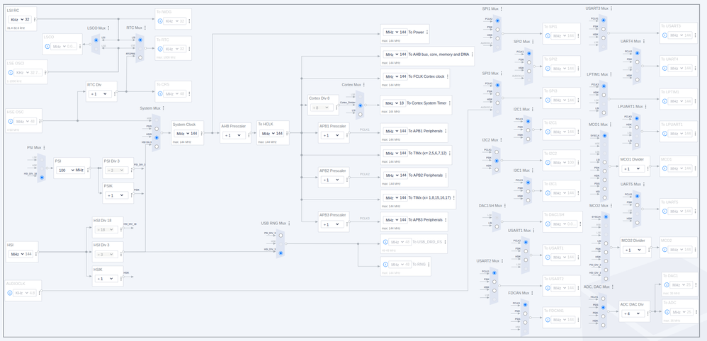

I have a problem verifying the HCLK frequency for Nucleo-C562RE. I configure the clock to 144MHz (see image below).
When I start the application I print the HCLK frequency:
SEGGER_RTT_printf("---- MCU started at %lu[Hz] ----\n", HAL_RCC_GetHCLKFreq());
I get 48MHz:
---- MCU started at 48000000[Hz] ----
While stepping through the HAL_Init code I see that the code thinks that the clock source is LL_RCC_SYS_CLKSOURCE_STATUS_HSIDIV3 (48MHz)

However the clock diagram indicates HSIS as the source of clock for System Mux.

@gil_dobjanschi, RCC is disabled. Please enable it and test one more time.

HSIDIV3 is the default after reset. Is it possible the clock has not been changed yet in your code? Where are you calling HAL_RCC_GetHCLKFreq in relation to clock being set? Including your IOC or code may help.
Hi TDK,
I called it before mx_system_init and after mx_system_init in the while(1) loop of the application. It always prints 48MHz. I attached the zipped ioc2 file.

I confirm that by simply activating RCC the clock value is now correct. Specifically it is 48MHz on startup, before  invoking mx_system_init, and 144MHz right after mx_system_init. Thank you for the help!
