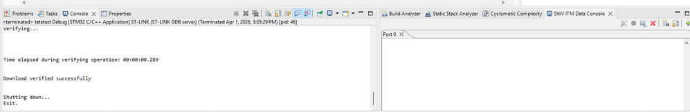

I am trying to print data but nothing seems to be working , I do not have cables to use COM, but I am sending data using SWV ITM, anyone who might know what's wrong , thanks!.

KING2
When I upload the code it works as excepted on the SMT32F407-DISC1 board, but timestamps can not show in the SWV interface

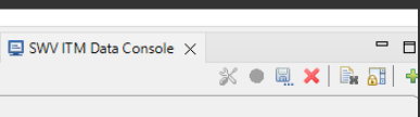

Hello @KING2, and welcome to ST Community!
To enable timestamps during debugging, click on the wrench icon in the debug toolbar and check the option Enable Timestamps.

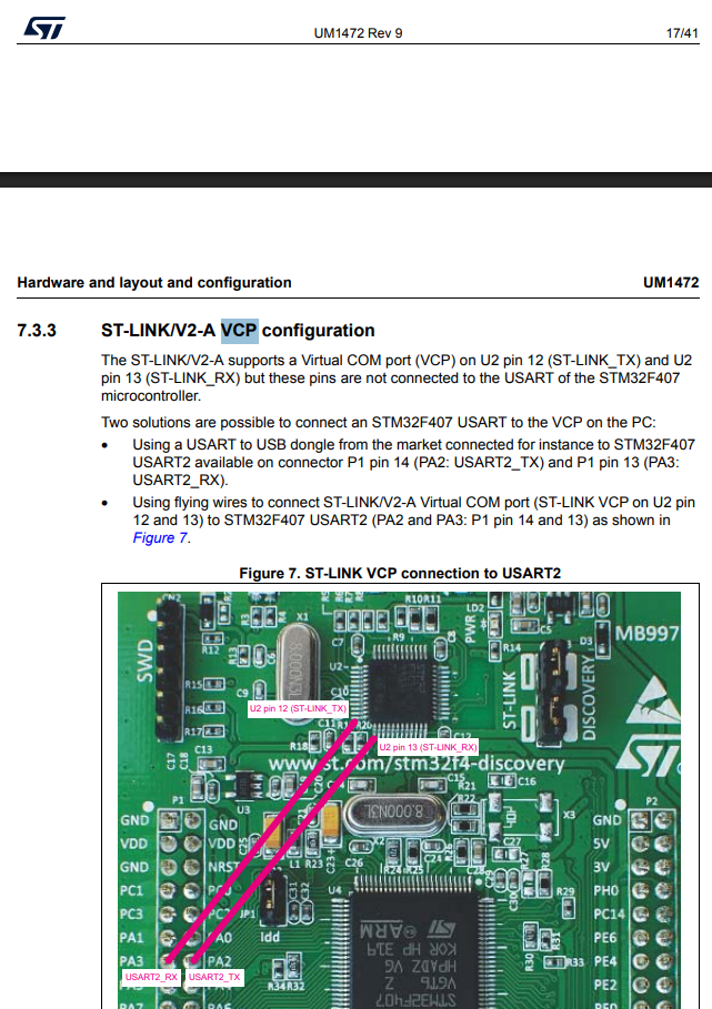

@KING2 wrote:
SMT32F407-DISC1
The User Manual tells you how to add the VCP (Virtual COM Port)  connection:
https://www.st.com/resource/en/user_manual/um1472-discovery-kit-with-stm32f407vg-mcu-stmicroelectronics.pdf#page=18
via: https://www.st.com/en/evaluation-tools/stm32f4discovery.html#documentation
Alternatively, just add an external USB-to-UART adaptor
