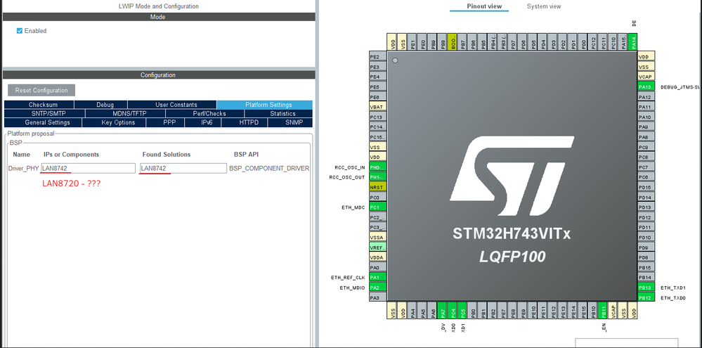

I have a ethernet module "LAN8720" and I have STM32H743VIT8. But MCU has only "LAN8742" driver. Is it possible to add the "LAN8720" driver to the list of drivers?0693W00000GYGImQAP.png

You can take the driver from the ARM CMSIS collection, here.
DK.7
DK.7Author
November 19, 2021
Thank you for answer, and in what folder I have to put it for appear it in the list of "Driver_PHY"?
Pavel A.
November 19, 2021
Put the .c and .h files in any place where you like.
Then add them to your project manually and call from your ethernetif.c.
Let the Cube/CubeIDE think that you use LAN8742.
