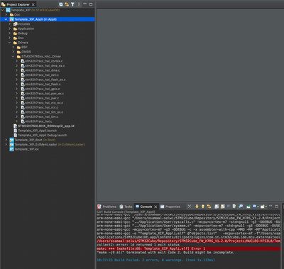

This is exactly what I tried, but for some reason, it doesn’t work—neither on my Mac nor on Windows. I’ve tried reinstalling STM32CubeIDE with no success. I also ran the IDE as administrator on both macOS and Windows, but that didn’t help either. Lastly, I gave it a try using STM32CubeMX, but still no luck.
Here’s a screenshot of my setup: I imported the Template_XIP project from the following path:
STM32Cube/Repository/STM32Cube_FW_H7RS_V1.2.0/Projects/NUCLEO-H7S3L8/Templates/Template_XIP
thanks :)

I tried it on windows and it works. i think it is a problem with macOS.
Thanks :)
