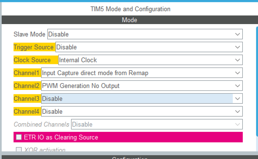

Hi I am having issues with cube MX, why am I unable to set timer 5 to anything when I have PA1 and PA1_C in use ?

My question is why am I unable to change PA1_C as timer 5 in my .ioc file thank you !
‎2021-09-15 8:25 AM
PA1_C is not a valid pin for TIM5_CH2 directly. PA1 is, but you're already using it for TIM2_CH2.
You can connect PA1_C and PA1 internally, but since one is already in use, that won't help.
If you clear the function on PA1, you can set PA1_C as TIM5_CH2 as expected.
