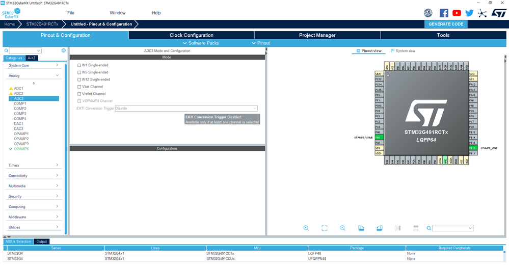

Can G491 OPAMP6 be connected to ADC3?
‎2021-03-19 8:22 PM
In RM0440, STM32G491 is Category 4.
Therefore OPAMP6 can be connected to ADC3 refer to RM0440 21.4.4(ADC Connectivity)
But I cannot find check option for OPAMP6 in ADC3 setting.
Is it unavailable? or not implemented yet?

‎2021-03-19 8:57 PM
in "stm32g4xx_ll_adc.h" OPAMP6 is available in ADC3.
It seems just cubemx bug
‎2021-03-22 6:26 AM
Hello @yjsbd​
Thank you for your feedback,
I have checked on my side and yes, you're totally right, there's an issue in CubeMX regarding the OPAMP6 connectivity with ADC3, a VOPAMP6 Channel is missed under ADC3.
Thanks for raising this issue to our attention :) it will be fixed.
Khouloud
‎2021-08-19 1:33 AM
Hello @yjsbd​ ,
I'm back again to inform you that issue is now fixed, you can use the latest CubeMX version availabel on site :)
Khouloud
