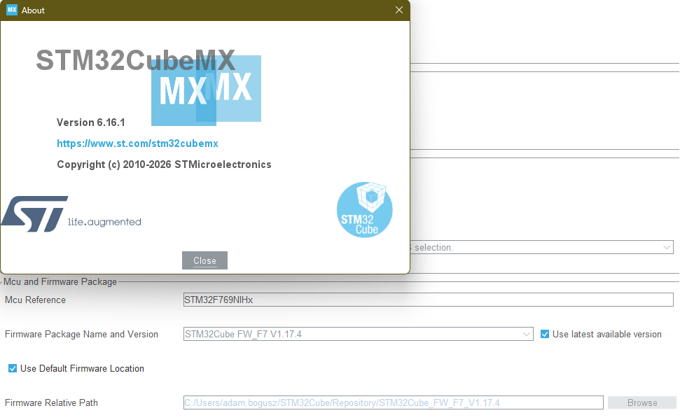

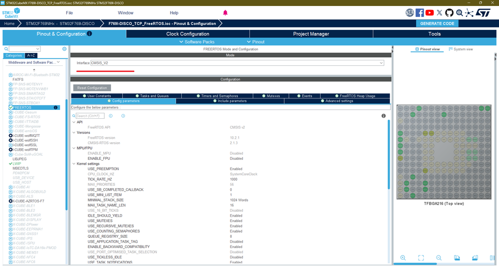

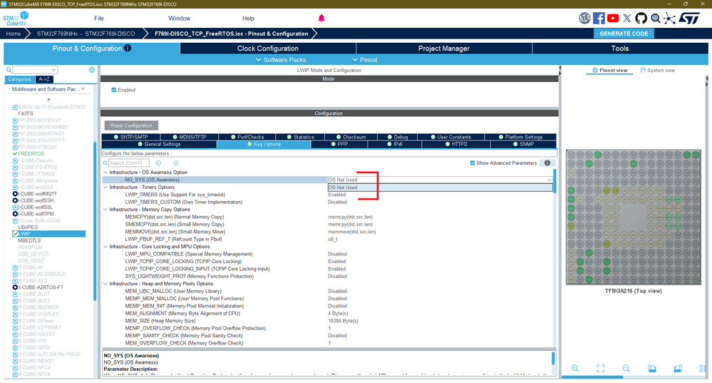

I have encountered a problem - I am unable to create a project for STM32F769I-DISCO board with both FreeRTOS using CMSIS_V2 interface and LwIP with NO_SYS parameter set to "OS Used".
In old project that was setup with STM32CubeMX V6.14.0 using STM32Cube FW-F7 V1.17.2 I had no problem with setting both CMSIS_V2 and "OS Used" value.
In new project that uses STM32CubeMX V6.16.1 and STM32Cube FW_F7 V1.14.4 I have to use CMSIS_V1 interface for FreeRTOS if I want to change LwIP's NO_SYS parameter to "OS Used".
Did something change in recent updates, is it a bug or am I doing something wrong? Thank You for help in advance.
Using FreeRTOS with CMSIS_V2Using FreeRTOS with CMSIS_V2
Can't change NO_OS parameterCan't change NO_OS parameter
CubeMX 6.16.1, Firmware F7_V1.17.4CubeMX 6.16.1, Firmware F7_V1.17.4

The CMSIS_V2 API is not supported for the STM32F7 series when using LWIP. Please use CMSIS_V1.

After checking internally, the STM32F7 LwIP implementation (CubeFW and CubeMX) has not been updated to CMSIS V2. Since the product is currently under limited and reduced maintenance, there are no plans to perform this update for the moment. That confirms my saying above.
All right, thank You. May I ask where is it noted that STM32F7 series doesn't support CMSIS_V2? Also I still wonder why older CubeMX allowed me to run LwIP with FreeRTOS using CMSIS_V2 and newer doesn't allow this, and both CubeMX versions allow to choose CMSIS_V2 even though it is not supported.
"Allows you" doesn't mean it's possible in real.
I will ask for a possibility to add a warning in CubeMx telling the user that's not possible to select LWIP+CMSIS V2 when he selects STM32F7 product. I'll get back to you for the team feedback.
