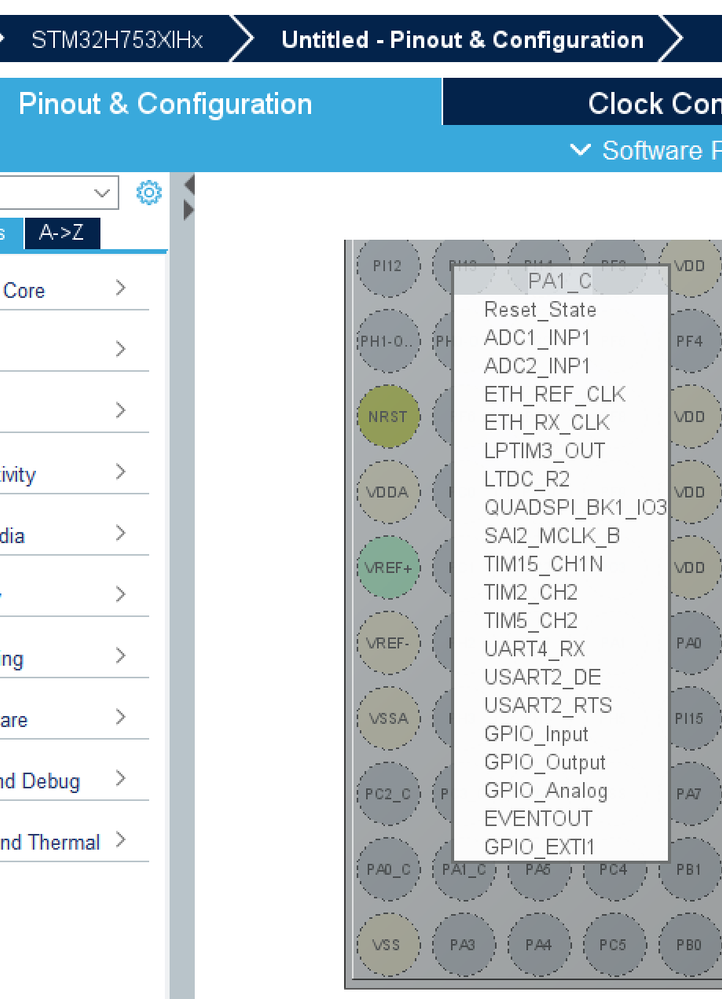

Hi I am concerned about the following microcontroller : STM32H753XIH6TR
When using cube Mx to configure the timers on pin PA1_C the options specified in the data sheet are not avaliable.
How do I access these functions?

Please see attatched image of functions specified in datasheet.
Please see image attatched of functions avalailable on cube MX
Thanks for your help !

‎2021-08-11 7:15 AM
No such issues here. Brand new project:
CubeMX v6.3.0
STM32Cube FW_H7 V1.9.0

‎2021-08-11 7:22 AM
Still remains an issue for me

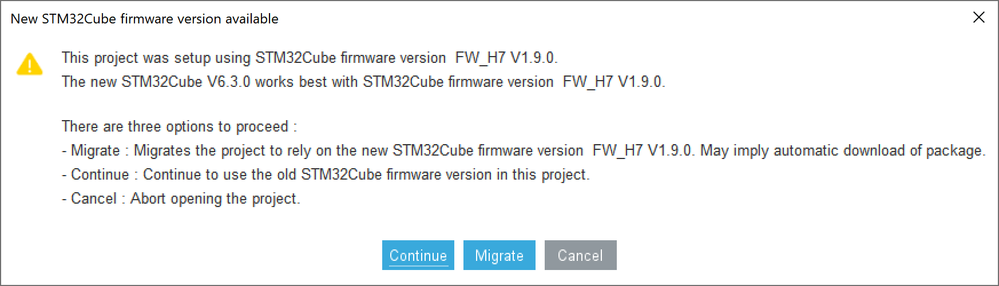

‎2021-08-11 7:45 AM
‎2021-08-11 7:45 AM
When opening your file, I got a bizarre message wanting me to migrate to the latest version, even though the name was the same.
Anyhow, I did so and was able to select all the functions shown in my post.
I suggest trying to download the newest H7 package and migrating to that. (Help -> Manage embedded...)
