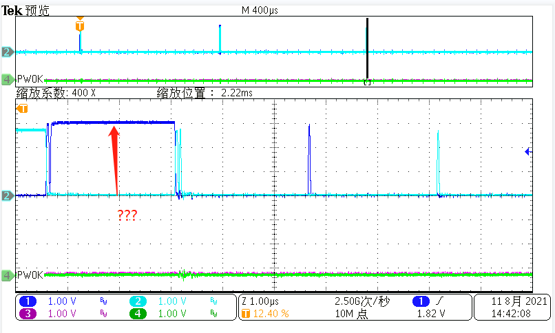

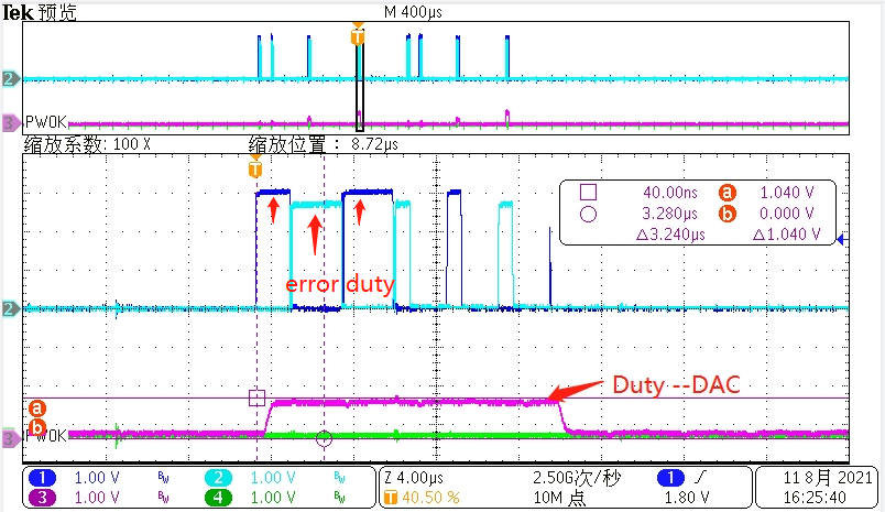

How to configure the STM32G4 HRTIM to control a half-bridge LLC converter with synchronous rectification?
  • August 12, 2021
  • 1884 views
Please check my ico and code,What is wrong with my configuration?
TIMA and TIMB must be updated simultaneously with the master timer repetition event.

My configuration is using 'Reset Trigger' instead of 'Update Trigger'.
JGrap.1
August 13, 2021
and I also enable Repetition Update for both TIM.
This's work for me. hope it help you. too.
