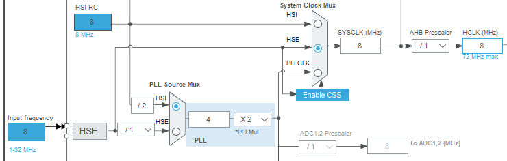

The code generated by CubeIDE is as follows, and it is automatically generated, and the code has not been modified at all. RCC Mode is set to BYPASS Clock Source and Master Clock Output is disabled.

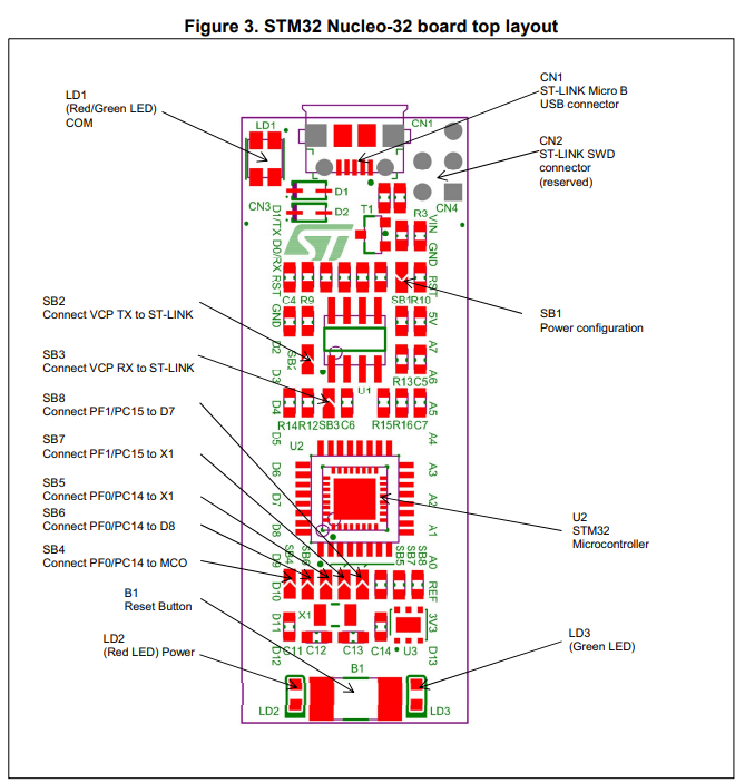

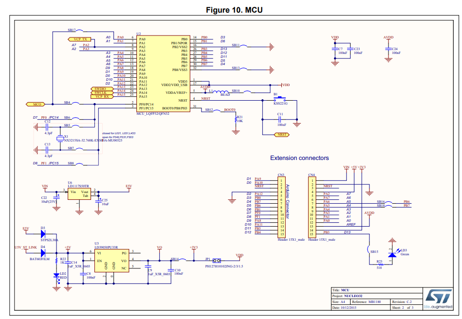

I am trying to use Nucleo-F303K8 with external clock from PF0(D7).
According to UM1956 Page33 Figure10.
Connection OSC-IN to PF0(D7) should be soldered SB6 ON and desoldered SB4.
It is mismatched on Table 6.
Actually shipped board setting SB6 is soldered as MCO from ST-LINK.
And it works correctly by ST-LINK clock.
I believe SB4 and SB6 in silk and circuits are opposite.
