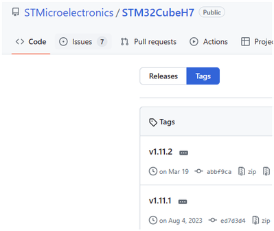

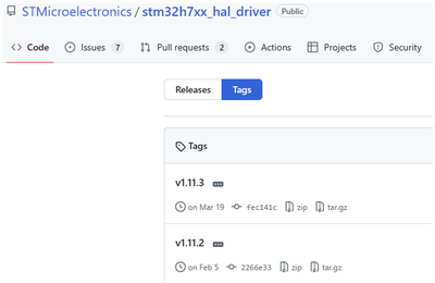

@unsigned_char_array There's mismatch between versions of H7 HAL drivers repo and the "jumbo package".
As you can see on github, the jumbo pack 1.11.2 of Mar, 11 contains HAL drivers 1.11.3
STM32CubeH7 jumbo package 1.11.3 is not available on github yet.
You're not the 1st person confused by this ))

‎2024-05-14 8:31 AM
The github H7 version v1.11.3 was released on 2024-03-19 while STM32CubeMX 6.11.1 was released on 2024-04-25. So why wasn't that version included in that version? When can I expect that release?

‎2024-12-11 8:41 AM - edited ‎2024-12-11 8:41 AM
Version v1.12.0 of Jumbo pack is now available (1.11.3 was skipped): https://github.com/STMicroelectronics/STM32CubeH7/tags
STM32CubeMX_V6.13.0 is available too.
I've downloaded them. It turns out we made some modifications in the USB library to make it non-blocking and to fix some bugs. Due to updated header files the source files needed to me merged. I added comments in the modified section to make merging easier and then merged them with the new files. Now everything works. It looks like the new USB library has some fixes.
