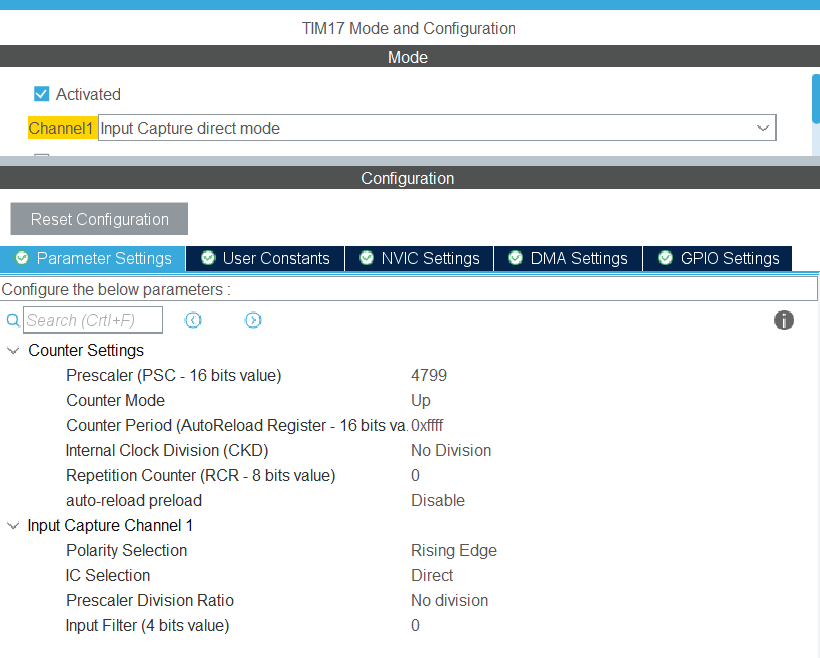

Method - Input Capture

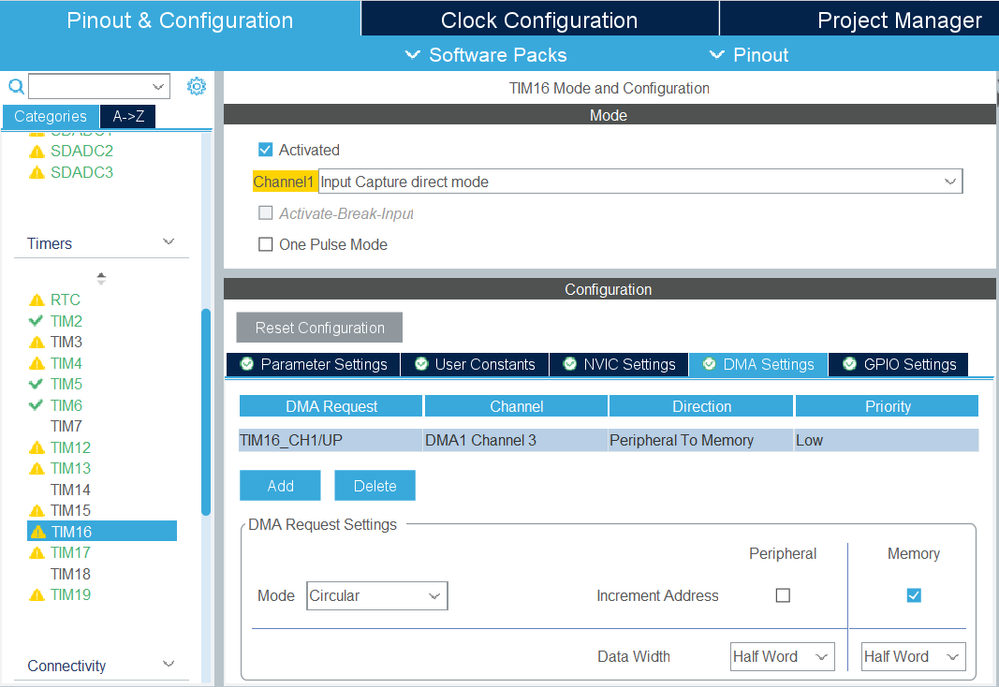

First I enable the input capture with this code.
volatile static uint16_t input_capture0[2] = {0};
volatile static uint16_t input_capture1[2] = {0};
void STM32_PLC_Start_Input_Capture(TIM_HandleTypeDef* htim17, TIM_HandleTypeDef* htim16) {
	 * Input capture for measuring frequency
	 * For TIM17 and TIM16
	 * Timer clock: 48 Mhz
	 * Prescaler: 4799
	 * Counter: 65535 (0xffff)
	 * Update frequency: 0.1526 Hz (1/0.1526 = 6.5535 seconds)
	 * Example: For every second, it will count 10000
	 * Lowest frequency measurement: 1/(0xFFFF*0.0001) = 0.1526 Hz
	 * Highest frequency measurement: 1/(1*0.0001) = 10000 Hz
	if(HAL_TIM_IC_Start_DMA(htim16, TIM_CHANNEL_1, (uint32_t*)input_capture1, 2) != HAL_OK)
		Error_Handler();
	if(HAL_TIM_IC_Start_DMA(htim17, TIM_CHANNEL_1, (uint32_t*)input_capture0, 2) != HAL_OK)
		Error_Handler();

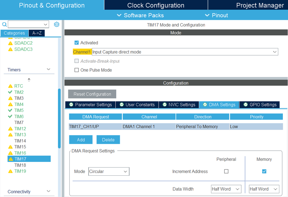

They both DMA are for circular modes.
0693W00000D2UKvQAN.png0693W00000D2ULFQA3.pngThe purpose with the arrays above, is that I can compute the freqeuency by calling the function

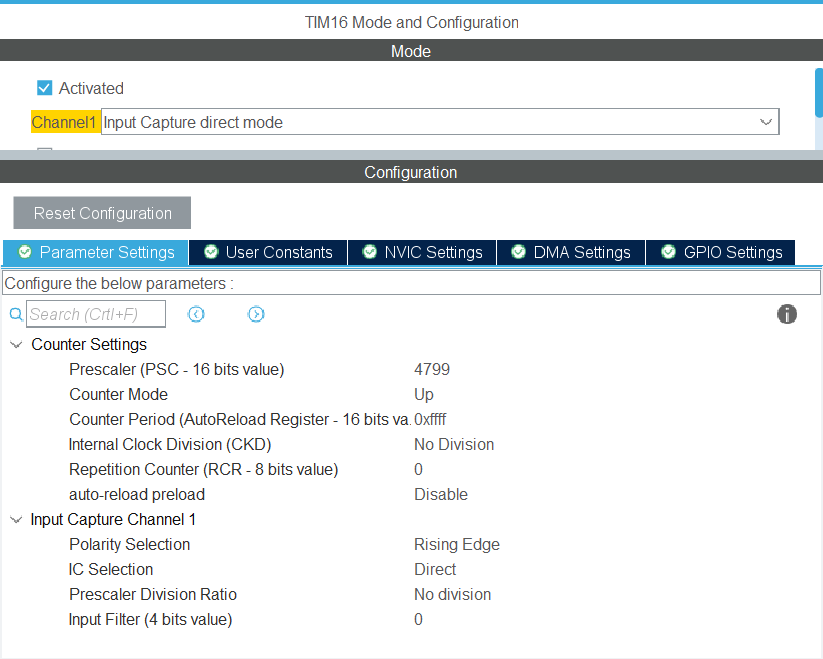

TIM17 and TIM16 have the same configurations.
0693W00000D2UMcQAN.pngMethod - Sigma Delta ADC

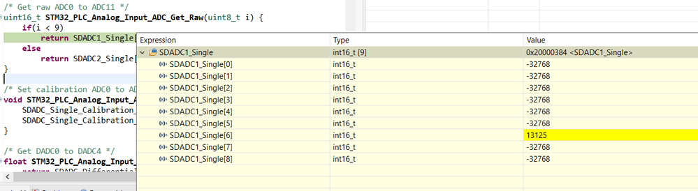

volatile static int16_t SDADC1_Single[9];
volatile static int16_t SDADC2_Single[3];
volatile static int16_t SDADC3_Differential[5];

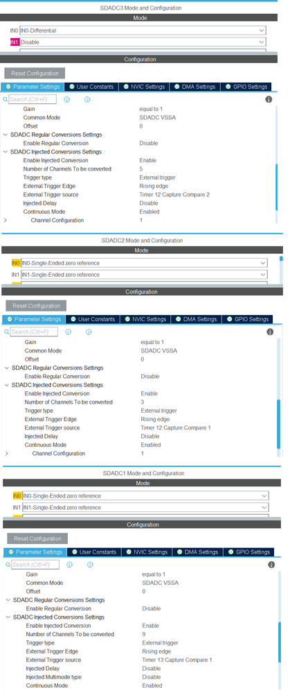

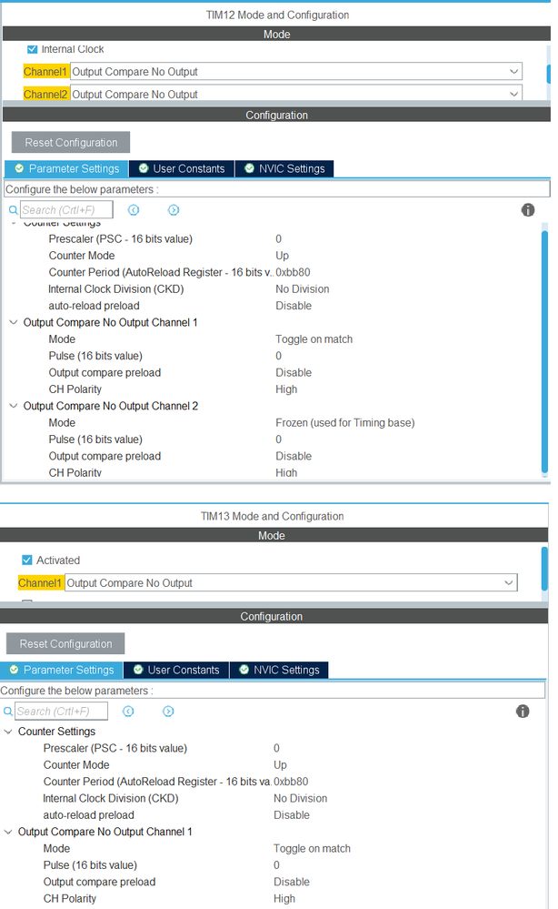

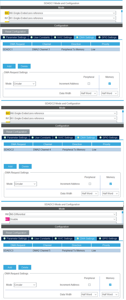

Here is DMA configurations for SDADC1, SDADC2 and SDADC3.0693W00000D2UMrQAN.pngI have also selected Injected Conversion and using a timer for calling the SDADC function.
0693W00000D2UMwQAN.pngAnd the timers TIM12 and TIM13 for SDADC.
0693W00000D2UNGQA3.pngI also can change gain on the Sigma Delta ADC while the STM32 processor is running.

Result - Input Capture
These arrays gets different values when the STM32 processor runs.
I can read them, but ONLY input_capture0 (TIM17) get updates values. ONLY input_capture1 (TIM16) get values once, then nothing happens any more.
Result - Sigma Delta ADC
When I try to change the gain for the Sigma Delta ADC, I call this function. This is just an example for illusration:
if(HAL_SDADC_InjectedStop_DMA(mySDADCHandler) != HAL_OK)
	Error_Handler();
Then inside the function, this calls to abort the HAL_DMA.
HAL_StatusTypeDef HAL_SDADC_InjectedStop_DMA(SDADC_HandleTypeDef *hsdadc)
  HAL_StatusTypeDef status;
  /* Check parameters */
  assert_param(IS_SDADC_ALL_INSTANCE(hsdadc->Instance));
  /* Check SDADC state */
  if((hsdadc->State != HAL_SDADC_STATE_INJ) && \
     (hsdadc->State != HAL_SDADC_STATE_REG_INJ))
    /* Return error status */
    status = HAL_ERROR;
  else
    /* Clear JDMAEN bit in SDADC_CR1 register */
    hsdadc->Instance->CR1 &= ~(SDADC_CR1_JDMAEN);
    /* Stop current DMA transfer */
    if(HAL_DMA_Abort(hsdadc->hdma) != HAL_OK)
      /* Set SDADC in error state */
      hsdadc->State = HAL_SDADC_STATE_ERROR;
      status = HAL_ERROR;
Continue below:

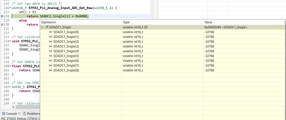

Hi!
I found a solution for Input Capture. It's a bug inside STM32CubeIDE 1.7.0.
Solution:
Move MX_DMA_Init();
  MX_GPIO_Init();
  MX_DMA_Init(); <--- To here
  MX_DAC1_Init();
  MX_DAC2_Init();
  MX_RTC_Init();
  MX_SPI2_Init();
  MX_TIM2_Init();
  MX_TIM5_Init();
  MX_SPI1_Init();
  MX_TIM4_Init();
  MX_SDADC1_Init();
  MX_SDADC2_Init();
  MX_SDADC3_Init();
  MX_CAN_Init();
  MX_USART1_UART_Init();
  MX_TIM6_Init();
  MX_TIM12_Init();
  MX_TIM13_Init();
  MX_TIM16_Init();
  MX_USB_DEVICE_Init();
  MX_FATFS_Init();
  MX_TIM17_Init();
  <--- From here
  MX_TIM19_Init();
  /* USER CODE BEGIN 2 */
This results:
  • Input Capture + DMA works
  • SDADC + DMA works, but I only get -0x8000 = -32768 (int16_t) because all my inputs are attached to GND. It seems that even if I have circular buffer, it still acts like it's Normal Mode. I can't change these values if I apply higher voltage onto the SDADC inputs. Hm...

this line looks suspect:
else if(input_capture[1] == 0x7FFF && input_capture[0] == 0x7FFF)
should be more parentheses in there, the && is not guarded
Tim16 and Tim17 are they synchronized ? , can you use 2 channels from the same timer ?
not sure why you have to start and stop the DMAs
I set my DMAs at startup, and let them run forever in circular buffers,
just track the DMA Count to know where it is.
this whole routine looks a bit odd, considering you cant guarantee the timers are synchronized
	if(input_capture[1] > input_capture[0]) {
		return (float) 1/((input_capture[1] - input_capture[0])*0.0001f);
	} else if(input_capture[1] < input_capture[0]) {
		return (float) 1/((input_capture[1] + 0xFFFF - input_capture[0])*0.0001f);
	} else if(input_capture[1] == 0x7FFF && input_capture[0] == 0x7FFF){
		return (float) 1/(0xFFFF*0.0001f);
	} else {
		return 0;
do you need to calibrate every time ? it is not quick to calibrate...
I don't know. I thought it would be best to calibrate for every time I start up DMA.
Actually, no. If the counter hits half of 0xFFFF twice, them the difference is 0xFFFF.
&& is dominat. Just as * goes before + and -
Why not? In this case, TIM16 and TIM17 does not be synchronized. They are two different Input Captures.
Because HAL_SDADC_PrepareChannelConfig says in the comment above the function.
This function should be called only when SDADC instance is in idle state
  *         (neither calibration nor regular or injected conversion ongoing)
Assume that you have a counter value from 0 to 65535. The first counter value is going to be saved at index 0 and the second counter value is going to be saved at index 1. When I call the function, I read the difference between index 1 and index 0.
Going from 0 to 65535 takes 6.5535 seconds due to the timer is 48 Mhz and 48*10^6/(1 + 4799) is 10000 couting values every second. That's 10kHz.
Assume that we have an Input Capture value of 10 at index 0 and next time it's 25 at index 1. The difference is the 25 - 10 = 15.
Next time we have a higher value at index 0. Let's say 35. Now the difference is 25 - 35 = - 10.

Hi!
Solution:
Move MX_DMA_Init();
  MX_GPIO_Init();
  MX_DAC1_Init();
  MX_DAC2_Init();
  MX_RTC_Init();
  MX_SPI2_Init();
  MX_TIM2_Init();
  MX_TIM5_Init();
  MX_SPI1_Init();
  MX_TIM4_Init();
  MX_SDADC1_Init();
  MX_SDADC2_Init();
  MX_SDADC3_Init();
  MX_CAN_Init();
  MX_TIM6_Init();
  MX_TIM12_Init();
  MX_TIM13_Init();
  MX_TIM16_Init();
  MX_FATFS_Init();
  MX_TIM17_Init();
  <--- From here
  MX_TIM19_Init();
This results:
STM32MP151AAC3 custom board with STM32-OS as operating system: https://github.com/DanielMartensson/STM32-Computer
STM32MP257FAK3 custom board with STM64-OS as operating system: https://github.com/DanielMartensson/STM64-Computer
I found a solution to the SDADC arrays.
Don't use the volatile keyword. That causing problems. Is that a bug too?
Now I get values when I apply voltage to the SDADC inputs.
