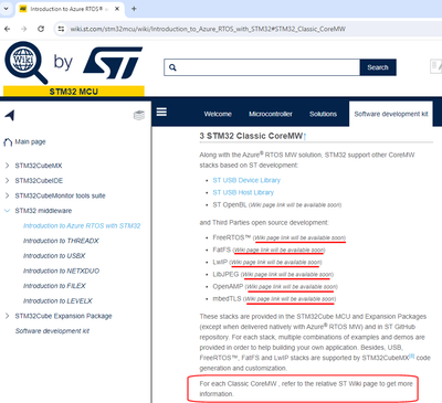

I would like to create a project with CubeMX where I handle files on a SD card with FAT Fs file system using a STM32U5 mcu.
When I select the STM32U5 MCU in CubeMX  the FATFS middleware is not available, while If I select other MCUs series like STM32F for example the FATFS Middleware is available.
I tried to find the FATFS software package to manually install it into CubeMX but I haven't found nothing.
Is FATFS middleware available for STM32US MCUs for CubeMX ?
Thanks for your help.

From that discussion it seems like there is no intention from ST to support FATFS Middleware for STM32U5 MCUs in CubeMX at all am I right ?
If we want to use FATFS we need to get the source code from https://github.com/STMicroelectronics/stm32_mw_fatfs/tree/master  include it in our projects and configure it manually ?
I do not want to use FileX in my project since it doesn't need to run with RTOS.

Hello @jacopokunak ,
In the STM32CubeU5 firmware, the file system has been migrated from FATFS to FileX.
I suggest that you to take a look at this POST in order to know more about it.
It demonstrates also how to develop a basic SD card file operations application.
