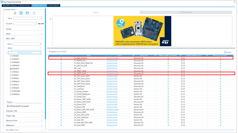

There are some examples available under C:\Users\<Your_User_Name>\STM32Cube\Repository\STM32Cube_FW_H7_V1.9.1\Projects for the STM32H747I-DISCO and for STM32H747I-EVAL which both have the same MCU as a Portenta H7 ( STM32H747XI ). These examples don't come with an .ioc file but they are helpful.
You can also find some examples under Example selector in CubeMX, some of which are Compatible with STM32CubeMX.

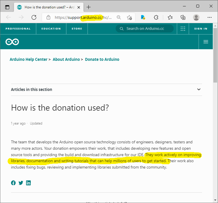

0693W00000HrTlyQAF.pngTry to ask on Arduino's forum. In my opinion, it's theirs job to do IOC files and/or examples for this board. Also contact them by using this form and describe your problem
https://www.arduino.cc/en/contact-us/
I can help with your project (spending hours on making IOC and more), contact by e-mail in my profile if interested.

Hello "thundertronics.com",
This idea is not bad...
I made such request there, but I don't think they would do it even if it were their job. Nowadays everything is different than it was in the past ...
