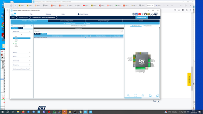

I am trying to catch a pulse on PB15. So I set the port PB15 to external irq with falling edge as per screen shot below
The code in MX_GPIO_Init() generated by MX is:
/*Configure GPIO pin : MPuls_Pin */
GPIO_InitStruct.Pin = MPuls_Pin;
GPIO_InitStruct.Mode = GPIO_MODE_IT_FALLING;
GPIO_InitStruct.Pull = GPIO_PULLUP;
HAL_GPIO_Init(MPuls_GPIO_Port, &GPIO_InitStruct);

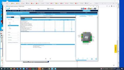

Primary check if EXTI in NVIC is checked.
Yes it is unless I am missing something
If I set the pin to read the IO I do get the level changes but not the IRQ
You write update what? I see sometimes on updates is it file empty = code for irq isnt generated.
Thanks for you help.  I reinstalled the software (cube) and it is working. Something must have gone wrong its working now.
I mean uncheck NVIC generate and check back next generate repair this, but this bug i see long time in MX
First generate after update fail produce right files...
