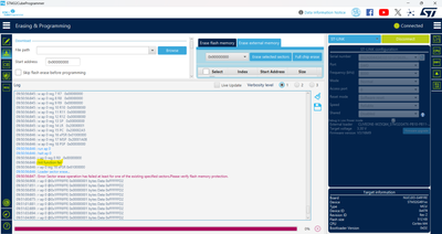

I am using NUCLEO-G491RE board and i want to create external flash loader for W25Q64JVSSIQ QSPI flash memory. I used external loader files from Github and build the .stldr file and placed in CubeProgrammer. when i try to read from 0x90000000 location, i am getting read failure error. I used the below path to create external loader for W25Q64JVSSIQ QSPI flash memory,
Driver code is working fine since I am able to see the data in memory mapped mode with test code provided in the github link.
But, when create a external loader using github files and placed .stldr file into cubeprogrammer and working on read/write/erase and these operations are failing.

Thanks for your quick feedback. I've tried with the above mentioned option and still read, erase and write operations are failing.

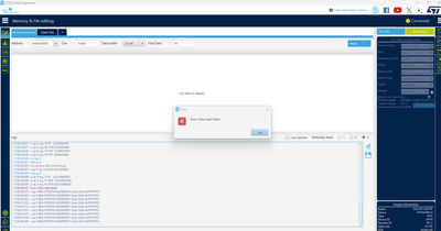

I am seeing Init function fail when i set log level to 3
Below is the reference screenshot

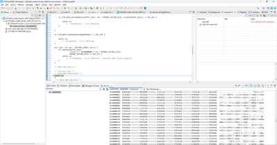

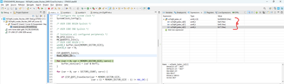

Device ID is reading correctly. For W25Q64JVSSIQ, Device is = 0xEF 40 17
// Manufacturer ID = w25q64_jedec_id[0]; // 0xEF (Winbond)
// Memory Type = w25q64_jedec_id[1]; //  0x40
// Capacity = w25q64_jedec_id[2]; // 0x17 for 64Mbit
CSP Implementation Screenshot:

Thanks for your feedback. I am exactly following the same as mentioned in the MOOC.
Using 6 dummy cycles for MemoryMappedMode()
