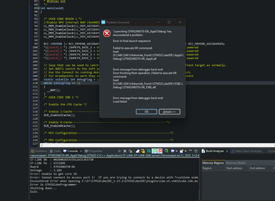

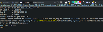

Hi Everyone,
I've been working on the N6 kit for a while. Initially, I was able to debug it, albeit with difficulty. However, in my latest attempts, I haven't been able to. I've updated Stlink, the IDE, and CubeProgrammer. I continue to receive the error below. I'm following all the instructions in the Readme. Also, as I mentioned, I've been able to debug it without any problems for about a month.
I know that debugging MCUs with external flash drives requires some special considerations. However, when they suddenly stop working after booting, it really makes the development process quite tedious. What should I check? I've eliminated things like the USB cable.
BR. Onur

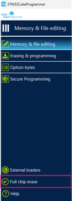

Hello @Okeskin ;
Thank you for updating post.
I noted that you are using an older version of STM32CubeIDE toolchain.
Could you please update your STM32CubeIDE 1.19.0 toolchain.
Also, I recommend you to try to connect your board using STM32CubeProgrammer and click on full chip erase.

Hi @KDJEM.1
I am using the STM32CubeN6 firmware example. I've been trying repeatedly. Sometimes the connection drops, and even after trying all the steps again, it still doesn't work. I'm starting to think there are connection problems between the Stlink and the Stm32n6. I'm using the Discovery Kit, but I can't understand why debugging is so difficult. We designed a custom board, and we can now debug it. However, I still suspect there are problems.
BR,
Onur
