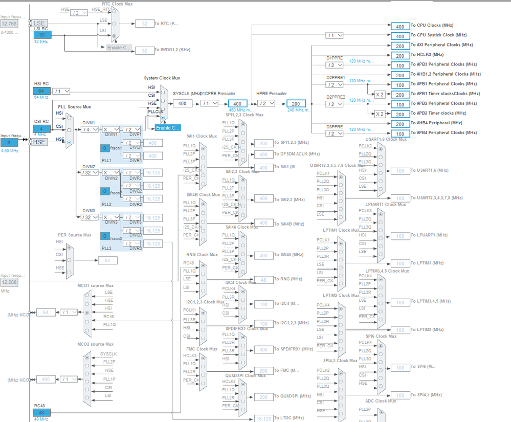

  4. Here is a snapshot of my clock configuration. I configure the clock to 400 MHz. I also set the high-speed clock (HSE) to bypass mode.

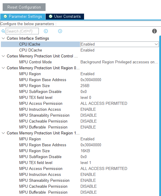

  6. Configure Cortex-M7. Here I enable ICache and DCache with MPU Contro Mode set to Background Region Privileged accesses only. Then, I set two memory protection units as follows:

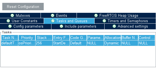

    1. Enable the FreeRTOS with CMSIS_V1 API.
    2. Increase the size of the default task stack to 256 words.
