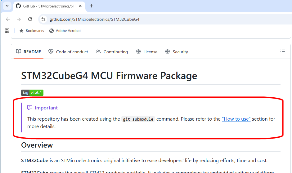

a github repo (https://github.com/STMicroelectronics/STM32CubeG4) cloned on my machine,  
ST's GitHub repos rely on submodules - so you have to follow the instructions to clone correctly:
Did you do that?

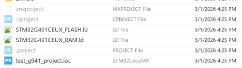

Just tried this and both .project and .cproject showed up as expected. Maybe you missed a dialog box, or maybe you have some other project setting which is incorrect, or maybe you have "dot" files hidden.

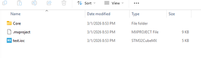

 These are all files that I get after pressing Generate button.
