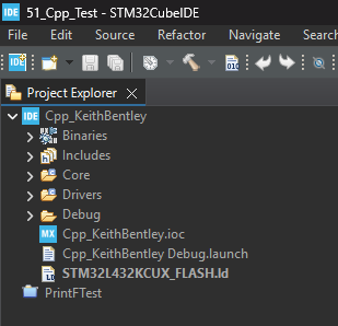

using STM32CubeIDE 2.1.1 and STM32CubeMX 6.17, I'm a little confused on how to import an existing ioc-file created by CubeMX into an existing project in CubeIDE. And to later modify it.
Confusion is drawn from this tutorial: https://community.st.com/t5/stm32-mcus/stm32cubeide-2-0-0-workflow-tutorial/ta-p/864831
At the end, it is somehow saying to use the import function of CubeIDE for an ioc-File which is located (physically) on a different location than the project itself (ioc-file in §2.3 tutorial c:/users/ST/Documents while project is in workspace 2.0.0, from which I assume it is stored in a different folder).
Then, later on in §2.5, MCU gets some modification (added I2C in the example) and code is newly generated (in c:/users/ST/Documents and CubeIDE requires a refresh (F5) to capture the updated MCU configuration) (see also equivalent video tutorial at around 4:05min)
So good, so confusing. Why?

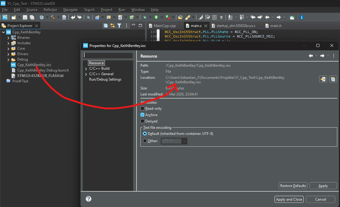

1) CubeIDE shows the ioc-file in the project tree, and is physically stored in the folder as the project (see attached screenshot)ioc-File in product tree and storage locationioc-File in product tree and storage location
Note that workspace is "Cpp_KeithBentely" (I'm investigating usage of C++).
So why is the ioc-File not directly saved in the location of the project? And the need to refresh is somehow indicating that there is a link between the ioc-File generated by CubeMX and the ioc-File used by CubeIDE. As, hopefully made clear enough, there are two ioc-files ... Shouldn't be one sufficient?

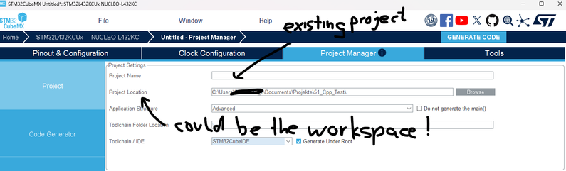

So, why not simply doing something like, where the new ioc-file is directly stored inside the workspace's folder on the harddisk. Note that project location is actually the workspace!
What I simply fear is something might be broken by doing so. Bascially because I haven't understood this eclipse-world just to a minor fraction in best case.
Not sure about CubeIDE 2.x behavior, but generally Eclipse CDT does not like when a project root directory is same as the workspace directory. This isn't forbidden explicitly but known as a sure recipe for problems.

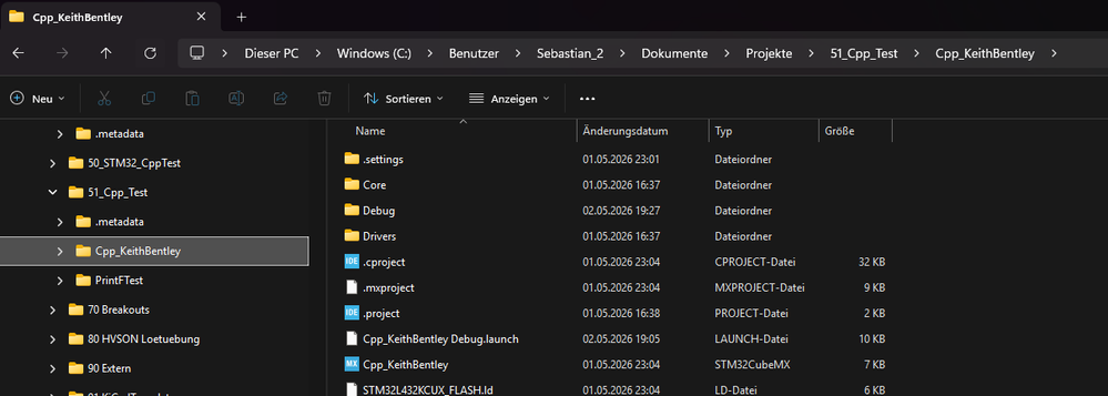

Probably some misleading wordings in the GUI of STM32CubeMX - I had similar thoughts as you, but at the end, in conjunction with "Project Name" a sub-folder is created (named what has been entered in the field "Project Name")  under the folder "Project Location", which actually STM32CubeIDE will identify as workspace later on.
So, with "Project Name" = "Cpp_KeithBentley" and "Project Location" = "51_Cpp_Test" I get the folders as shown below, and its equvialent in CubeIDE
File LocationsFile LocationsView in CubeIDEView in CubeIDE
So root directories are actually not the same. The project is one level below.

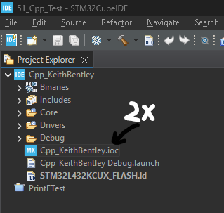

" If you just put a .ioc file in existing project, generation with standalone CubeMX can corrupt the existing project."
Any specific procedure to do this in mind? What I tried is the following:
  1. In CubeIDE copy an existing project A and paste as project B with ioc file MX_A.ioc
  2. Project B as still ioc-file MX_A
  3. Open MX_A.ioc in CubeMX, modify it and save it into the folder of Project B as MX_B.ioc by "save project as"
  4. Project B has not two(!) ioc-files: MX_A and MX_B
  5. Code is created new, but code between /* User xxx Begin ...*/ and /* User xxx End */ is untouched.

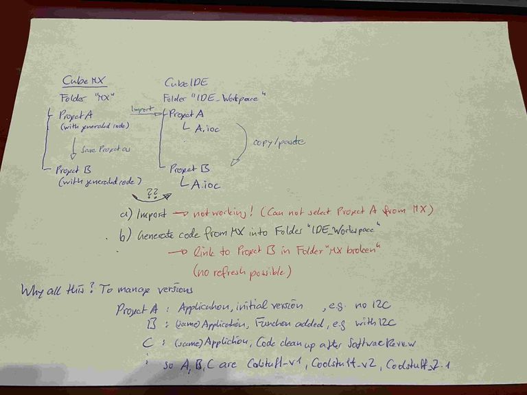

First have a look on my sketch below, in which I tried to draw what I like to do.
So, far I have seperated folders on harddisk to seperate projects created by CubeMX and CubeIDE. On the bottom the desired "what I want to do" is outlined. It is developping an application with several version (initial, a feature added, code clean up)
So far, the intial phase is doing fine. Project created in CubeMX in folder MX, generated code (in CubeMX), then close CubeMX, open CubeIDE and import project into CubeIDE. Link to ioc-File in Folder MX is maintained, i.e. when I modify something here, it will be updated in CubeIDE automatically, fine!

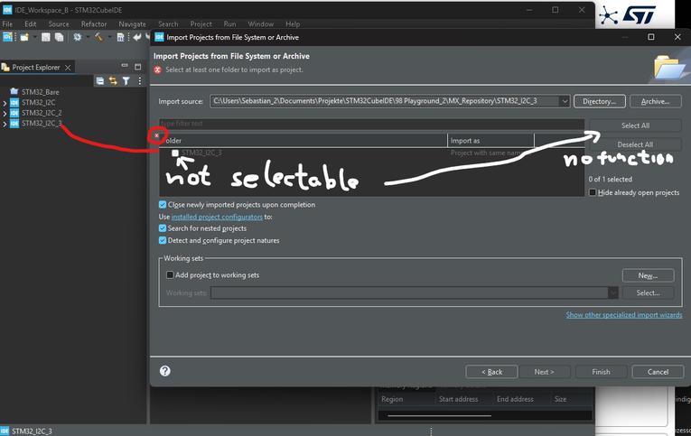

But then, Project B is created (i.e. the next version) by copy and paste (because I like to maintain all my user code). Then, ioc-File is not anymore referenced to the one in folder MX but in folder IDE (well, a copy created in IDE, so appears logical)
Unfortunately (see black arrow with ???) the import function is not available anymore, see below (Please note that I trying to import from folder MX (here: MX_Repository). It is not selectable (box can not be ticked, button select all is not doing anything)
Well, what does work is when I generated code directly from CubeMX into the workspace of CubeIDE - to the price that all user code gets deleted :( (there is a corresponding warning up front, so not a surprise at the end)
