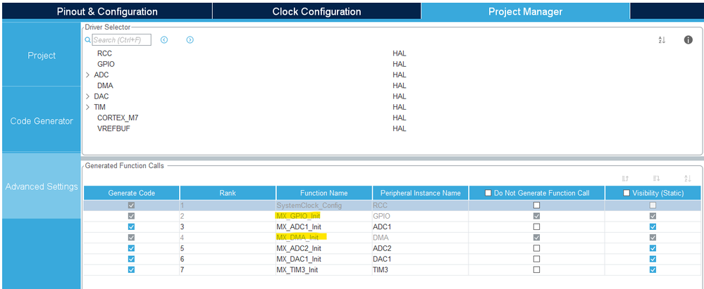

STM32CubeIDE v1.9.0 (and 1.8.0) is generating MX_DMA_Init() AFTER MX_DAC_Init() and this causes the functionality (DMA driving data to the DAC to play a wav file) to fail.

2022-05-18 1:54 AM
Hello NNar,
thank you for letting us know. We are aware of this issue and working on solution. Meanwhile you can solve this issue by disabling the functions calls of MX_GPIO_Init(); and MX_DMA_Init(); as in the screen capture below And the write this function calls USER CODE block SysInit:

2022-05-19 6:09 AM
Hello @NNar ,
Thanks for your feedback,
As @Petr DAVID mentioned, this is a known issue and we are working on it. You can solve this issue by applying what Petr suggested or alternatively by what is described in the following thread MX_DMA_Init order in the main.c file generated by STM32CubeMX, How to fix?
I hope this helps :smiling_face_with_smiling_eyes:
If your issue is solved, please close this post by clicking the "Select as Best" button. This will help other members of the community find this response more quickly :)
Sara.
