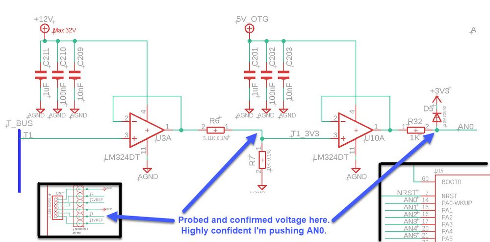

I'm individually driving my AN0..AN5 analog inputs, and I've confirmed that the ADC results are showing up in ADC_DMA_BUFFER[1..6]. I would have expected them in ADC_DMA_BUFFER[0..5]. Meanwhile, I'm configured for 7 conversions, the 7th being AN14. It's not showing up in either ADC_DMA_BUFFER[6] (the normally expected location) or ADC_DMA_BUFFER[7] (an otherwise buffer overflow location that was hinted at by the behavior of the first 6 channels). Finally, I'm unable to test if AN14 is erroneously going into ADC_DMA_BUFFER[0] (which would be a looped-back index location).
I've analyzed everything and I believe it's all lined up properly. Why might this be happening? Below is select cut/paste/images from my code and circuit. Thanks in advance for your help!

Thanks for participating, @Nikita91​ , but I get the feeling you didn't slow down to read the question -- or maybe I'm more confused than I realize. Specifically, the title question includes "Why is analog dma data". So analog is triggering the DMA, and it's doing so per HAL_ADC_Start_DMA().
To what bit are you referring? Are you referring to a DMA enable bit that is hidden from me and handled by HAL? The DMA *is* indeed happening, so any such enable bit must be set.
Is there possibly any bit setting that would cause the DMA transfer from the ADC result register to go into memory one position later in the array, and then also NOT into that ADC_DMA_BUFFER[7] position, otherwise overflowing what really should have been a 7 element array with last index 6, not 7?
