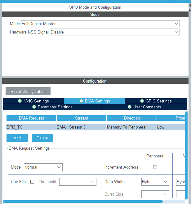

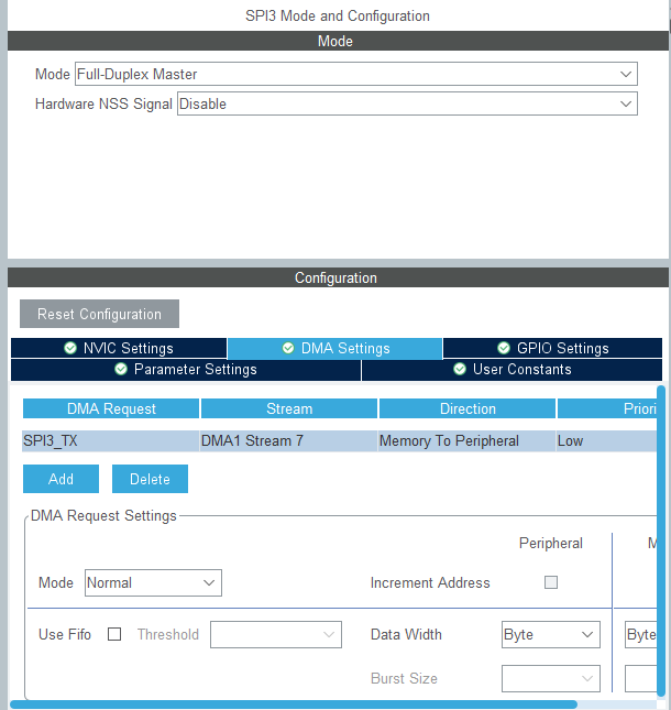

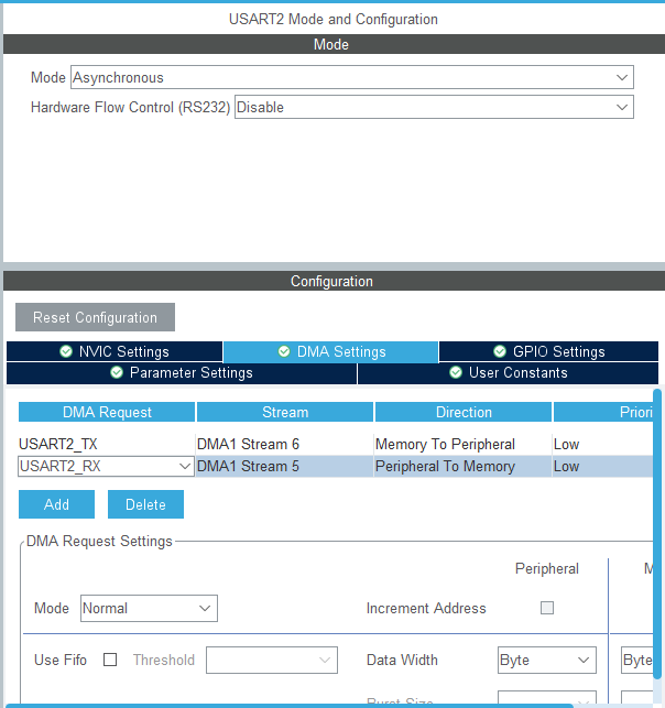

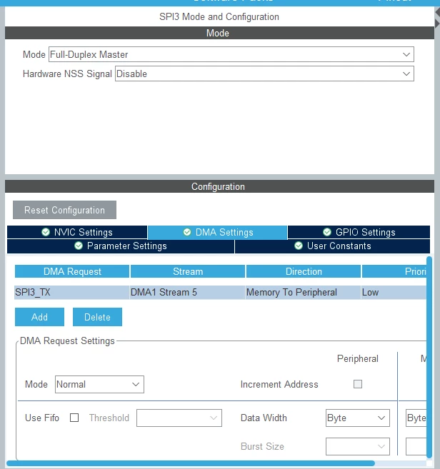

This is the scenario that I have followed and it works fine using STM32CubeIDE Version: 1.11.2
  • Activate SPI and add SPI3_TX DMA request and select the DMA1 Stream 5
  • Activate USART2 and add USART2_RX request
==> The USART2_RX request will be affected automatically to the DMA1 Stream 5
0693W00000YAN2pQAH.png==> The SPI3_TX stream settings will be changed to DMA1 Stream 7
0693W00000YAN34QAH.pngI also attached the *.ioc file which contains my configuration for reference.

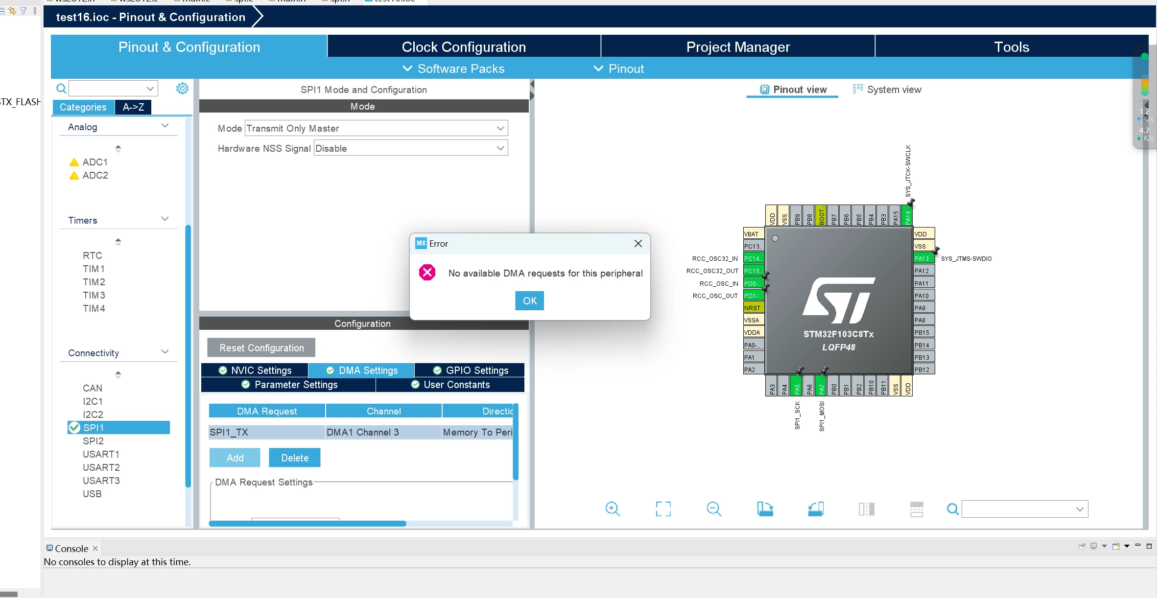

Visitor II
March 18, 2024
hi Romber
I'm not mean to bother you,but could you tell me how you fix the problem?
it seems that i meet the same situation
