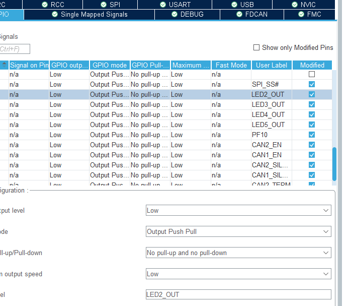

​After that, the user label will no longer be reflected.
I'm using CubeMX to import a previous project and using the latest version to generate the code.
Apparently, the label is peeling off at the timing of code generation.
This is the state before code generation.
User labels are well reflected here

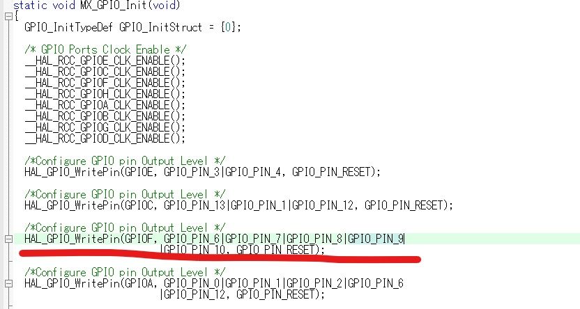

After generating the code, let's take a look at uVision.
The user label has come off.
0693W00000LzdtuQAB.jpg​

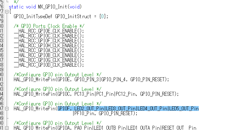

This is an old project, but it reflects the user label.0693W00000LzduEQAR.png​

I tried the following method and it worked.
"After resolution"
1. Open the original project of FW Ver1.9.1.
Migrate to FW Ver1.10.0.
2. Create a new project.
Import the project that has been migrated to 1.10.0.
3. Generate code.
"Before resolution"
1. Create a new project
Import the original project of FW Ver1.9.1.
2. Generate code with FW Ver1.10.0.
Original project
It seems that I had to move to 1.10.0.
