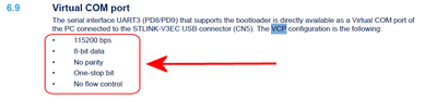

Also, please clarify what this mean:
Is it this part that you're asking about:
Those are just the settings that you'd need for any UART link.
https://learn.sparkfun.com/tutorials/serial-communication/all
  • Baud rate (aka "speed") = 115200 bits per second (bps)
  • Number of data bits: 8
  • Parity: None (no parity bit)
  • Number of Stop bits: 1
  • Flow control: None (neither any "hardware" option nor any "software" option)

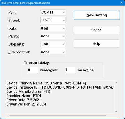

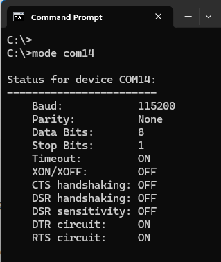

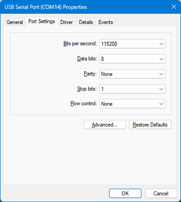

These are the settings that you always need to make whenever you connect any PC software to any COM port - virtual or otherwise.
For example, in TeraTerm:
In Device Manager:
Or at a "DOS Prompt":
So all exactly the same as you would for a real COM port, or any other USB-to-UART device (FTDI, in the above examples).
