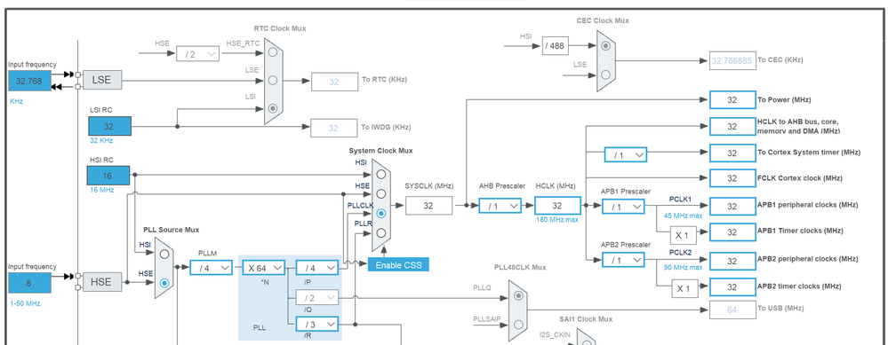

I am using NucleoF446RE (STM32F446RE) with CubeIDE 1.19.0.

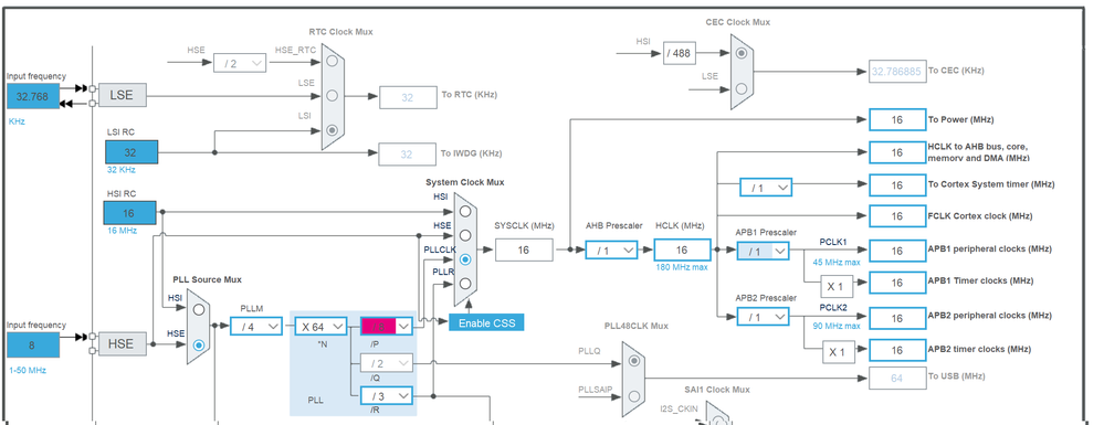

I wish to set PLL  as 16MHz by HSE (STLINK 8MHz MCO).
Because HSI clock is 16MHz.
I had set PLL M/N/P = 4/64/8.

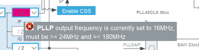

CubeMX reported P was fail . ]

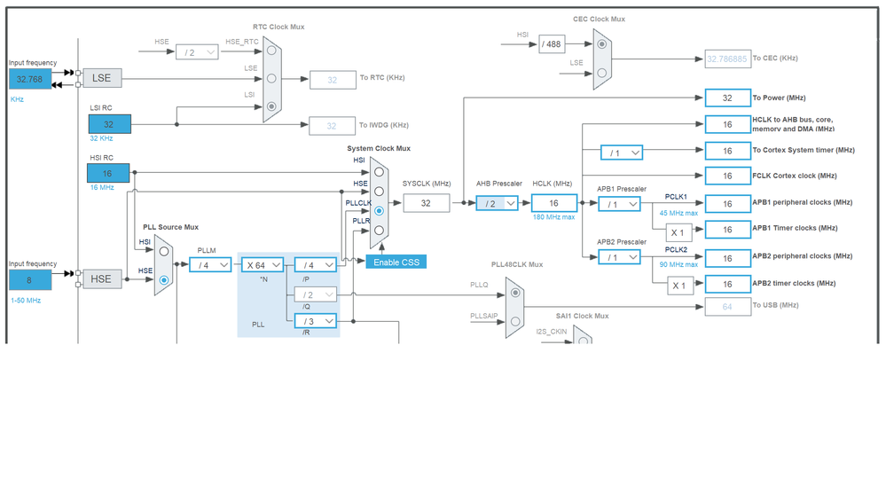

So I had set P=4. and It makes PLL-CLK = 32MHz

Hover over the red area to find an explanation of the issue. In this case:
Unclear why it wants that. Seems like a bug but I could be missing something.

I am referring on RM0390 (STM32F446xx).
I cannot find out 24MHz limitation on that.
Is it CubeMX message bundled information only ?

Dear TDK
Thanks for your explanation.
But I cannot see same display on CubeMX.
Is there any method or display setting on CubeMX ?
If 24MHz is minimum limit spec of PLL then I can recognize this issue is
spec.
I have seen Errta and Reference manual please navigate me on this point.

Dear TDK
I cannot see PLL clock minimum frequency spec is 24MHz now,
But it may cause issue of this setting.
My purpose is setting 16MHz clock for application as HSI clock.
I have settled following setup as create 32MHz for MCO and divide to following path.
