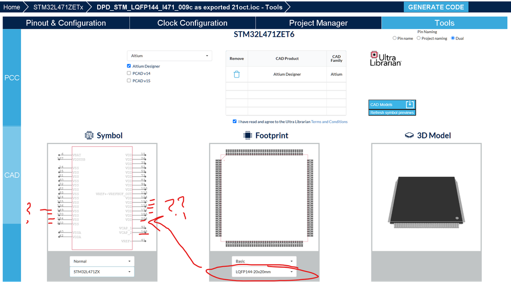

Trying to export LQFP144 pinout to Altium CAD models with cubeMX.
But CubeMX is trying add pin #204 #202 #158, etc, on symbol for an L471 micro that doesn't even come in packages  bigger than 144 pins.  Altium chokes on this symbol, I imagine that's because the foot print only has 144pins.
See screenshot below.  Will attach .ioc file if possible.

Hello @DixonDon
Thank you for spotting this!
This behavior will be investigated by the STM32cubeMX team (Internal ticket number: 194578), meanwhile, as a temporary workaround, you can manually edit the symbol in Altium Designer to remove the incorrect pins
