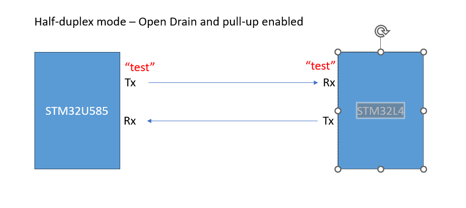

 I can now see data in both TDR and RDR registers. However, there is another issue that I am facing. Let me try and explain the issue -
I have two processors, that communicate with each other over UART. They communicate with each other in full-duplex mode and everything works great. There are no issues there.
However, I want to perform a self-test on each of the TX and RX pins of both the MCUs, to verify that they are operational and hence I want to put them in half-duplex mode and independently test them each. The weird thing that I see in half-duplex mode for STM32U585 Tx is that the co-processor(STM32L4) also receives whatever was sent by the STM32U585 Tx pin. When I send the string "test" in half-duplex mode on the STM32U585 Tx pin, I also receive "test" on the STM32L4 Rx pin. This is a normal behavior in full duplex mode and I am confused if this should be happening in the half-duplex mode as well.
Please help me understand if this behavior is expected. Your support is really appreciated!! Thank you so much!!
If the STM32U585 TX pin is connected to the STM32L4 RX pin, of course the latter is going to receive the characters you send out.
The example is a little confusing. In half-duplex mode, only a single pin is used (the TX pin). In your figure, both the TX and RX pins are shown and are connected separately.
Neharika
Sorry about the confusion. I just wanted to show that even if I have the STM32U585 TX pin(just one pin) configured in single-wire half-duplex mode, the physical connection b/w the STM32U585 TX pin and STM32L4 RX pin still exists.
So this is true even when the STM32U585 TX pin is configured in single-wire half-duplex mode? I just want to make sure that the two co-processors are independent of each other in the half-duplex mode.
Hope this was clearer.
Thanks,
Neharika
Pavel A.
If both MCUs work in single wire mode, they both use TX pin, so TX of one connects to TX of the other. Note that you can swap TX and RX pins on one side by software, in USART_CR2 register bit 15, so you don't have to solder.
Yes.
It's not very clear why you need to test the pins in single wire mode, but yes it seems to be behaving as expected given that scenario.
