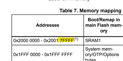

The reference manual gives misleading information here. 128 + 32 is not 196.
Datasheet is correct.
Another reference manual error: extra "F" in the address here:

The reference manual is still wrong if it has 0x2001_7fff as the upper limit.  That's just 96 kB.
