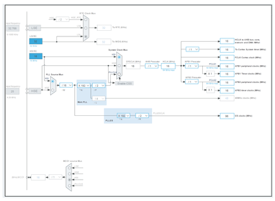

My current focus is the clock configuration, which is quite complex stuff for MC beginners. I have watched some YouTube vids from STM but I wondered, why the I2S clock ist so high, when I configure a I2S interface. At any sample rates it is set to 96MHz, even when the HCLK is only 16MHz.
I thought, the I2S clock is calculated by sampleRate*BitsPerSample*Channels, which is only 128kHz on 8kHz 16 Bit Sound. The minimum i2s multiplier is x50, in the screenshot you see my default configuration...
Can somebody explain or give some advice or sources on that clock Issue?
Cheers, Stipe
There's no issue here. What you are seeing is the kernel clock rate for the peripheral. It's not the data speed. The data speed will be much less according to the setup of the peripheral in the I2C tab. The data speed will typically be 100 or 400 kHz, but the kernel clock needs to be much higher so it can subsample appropriately.
16 MHz / 16 * 192 / 2 = 96 MHz.
