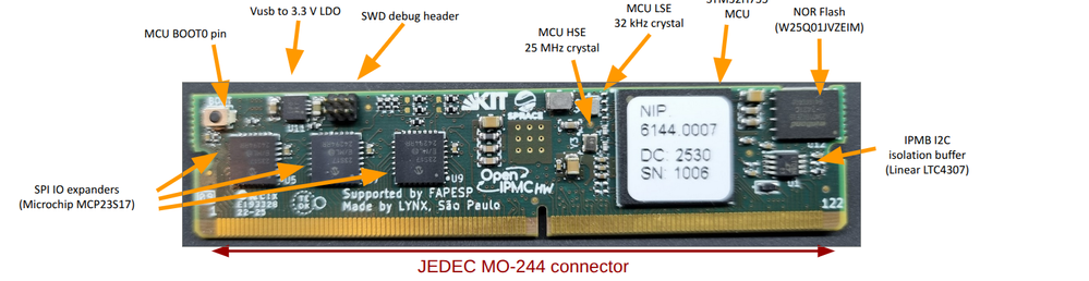

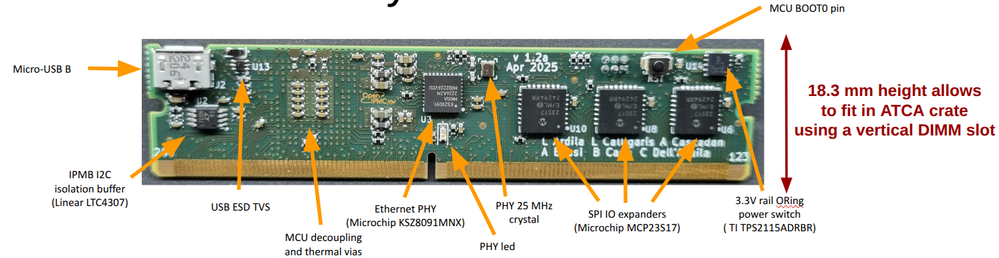

I also attached two pictures showing the front and back of the module I'm using.

And too internal system loader can block it based on ... As first your SWD connector on board is 2x2 , exactly you have here NRST GND CLK DATA ?

Also, as @MM..1 suspects, maybe NRST on your connector is not actually connected so "under reset" does not work? You wrote that you pressed the RESET button, but maybe it did not work. Try to press the BOOT button.
