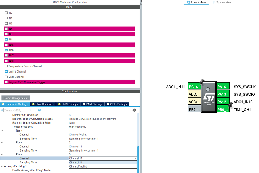

I'm trying to enable ADC channel 16 on STM32G031J6 but the IDE does not list up the channel.
What is the matter? How can I enable the channel?

‎2020-11-11 11:13 PM
Hello @SKiri​ ,
When sequencer is set to "not fully configurable" => CHSELRMOD = 0 in ADC_CFGR1
=> ADC_CHSELR is up to 19 channels (CHSEL 0 to CHSEL 18)
When sequencer is set to "fully configurable" => CHSELRMOD = 1 in ADC_CFGR1
=> ADC_CHSELR is able to sequence up to only 8 channels (CH 0 to CH 14)
The Rank configuration can be done only in the "fully configurable" sequencer case, for that, you cannot choose Channel 16 under Rank.

‎2020-11-12 6:36 AM
Ah! I see!
Thanks a lot.​
