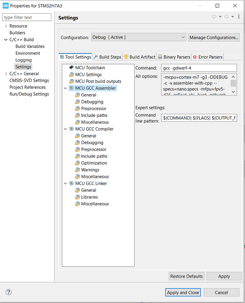

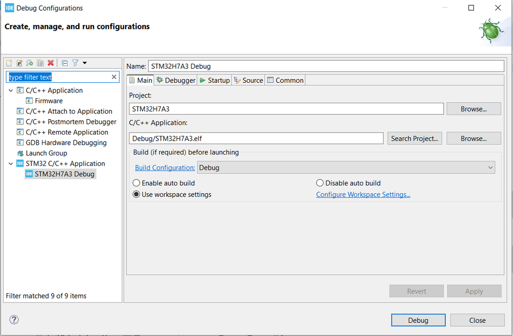

I am currently using the STM32H7A3VGT6 along with STM32 Cube IDE for debugging. My code starts properly in debug mode, but when I power cycle the device without the ST link connected, it sometimes executes and sometimes does not. I have turned ON three LEDs in the MX_GPIO_Init() function, but they do not light up when the code execution fails.
To address this, I adjusted the optimization level from -Og (debug) to O1 (level-1), and the code ran as expected without the debugger. However, after a while, the code stopped executing at optimization level O1, prompting me to revert to -Og for it to work properly again.
I have attached the project settings, debug settings, and code initialization for your reference.
CubeIDE version: 1.14.1

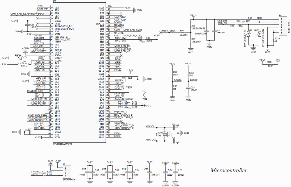

Hmm seems more as hw not sw trouble. 1. BOOT pins is managed right ? 2. HSE is managed right ?

Here are the hardware details:
  1. The BOOT0 pin is connected to GND via a 0-ohm resistor.
  2. The reset pin is pulled up with a 10k resistor and has a 100nF capacitor connected to GND.
  3. The VBAT pin is connected to 3.3V with a 100nF capacitor.
  4. The VCAP is 2.2µF.
  5. HSE 25Mhz crystal, SYSCLOCK = 240Mhz. Code attached.
When the RELEASE macro is disabled, the first function called after clock configuration is MX_GPIO_Init(), and in this function LEDs are initialized very first.
Please let me know if there's anything else I should check.
Thanks

Remove HSE 25M from board, config your sw to HSI and test. If all work OK = your HSE is problem.
Please post the schematic
Please note that this behavior is occurring across all boards.
Schematic attached.
