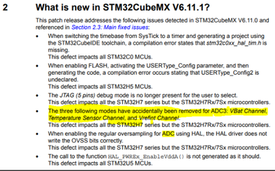

Hi there!
the lastest update of  CubeMX 6.11.0 invalidates rhe ADC settings for
ADC3.ChannelTS=ADC_CHANNEL_TEMPSENSOR
ADC3.ChannelVBAT=ADC_CHANNEL_VBAT
ADC3.ChannelVREF=ADC_CHANNEL_VREFINT
pre-update
MxCube.Version=6.10.0
MxDb.Version=DB.6.0.100
ProjectManager.FirmwarePackage=STM32Cube FW_H7 V1.11.1
update to
MxCube.Version=6.11.0
MxDb.Version=DB.6.0.110
ProjectManager.FirmwarePackage=STM32Cube FW_H7 V1.11.2
Cheers!
Imen.D
Hello @PGrif.2 ,
This issue is fixed in the latest patch release of STM32CubeMX v6.11.1.
Thank you for your contribution.
Thanks
Imen

Souhaib MAZHOUD
Hello @PGrif.2
Thank you for reporting.
Actually, this issue has been already reported internally to Dev team for correction (under internal ticket number 176642) and this will be fixed ASAP.
Thank you!
Souhaib

Hello @PGrif.2 ,
Thanks
Imen
