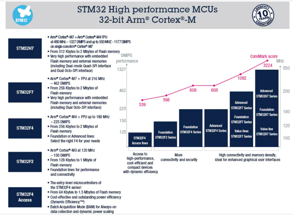

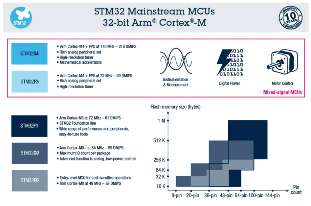

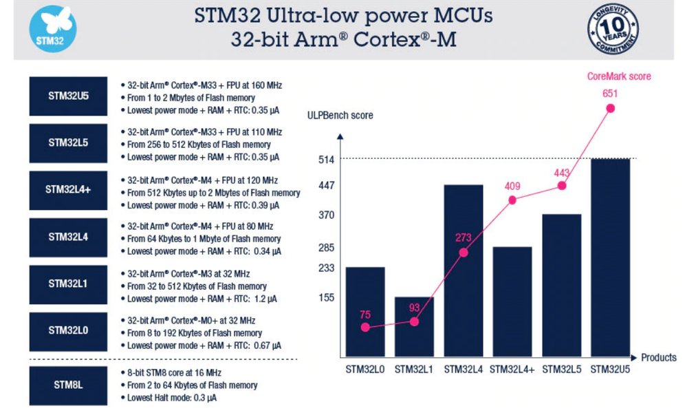

Can I find a place with a table that shows all the MCU compare including: CPU, memory ?
msror.1
Sarra.S
Hello @msror.1​ and welcome to the community,
Maybe these graphs can help you
Thank you for your contribution!
Sarra.

You mean the table with over 1300 entries?
You may select the MVU based on the requirements in STM32CubeMX/CubeIDE - just start creating a new project and the list of all STM32 MCUs will be displayed.
