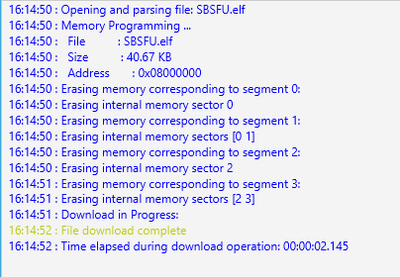

I am following all the instructions step by step but on STM32Cubeprogrammer after opening file "SBSFU.elf", downloading it and then reading it by memory, I see these messages in the Log section:

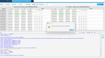

after it i try to compare the memory with the SBSFU.elf, and then I get these warnings:
When I check the bytes, I don't see any difference but this warning appears, and I cannot see the welcome message on Tera Term.

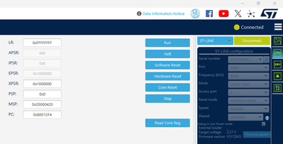

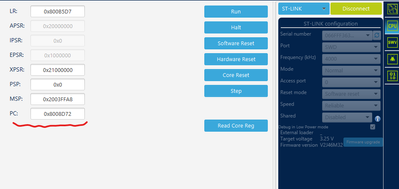

You can try using the CPU tab to check the value of PC register and now whether your MCU is properly executing the app. The address should be in flash somewhere at 0x08000000 :
PS: I've managed to reproduce the warning and it seems that it happens when comparing non contiguous binaries and memory => Not causing the app to not start, I suppose the download verification passes as expected.

Yes, the address is around 0x08000000.
