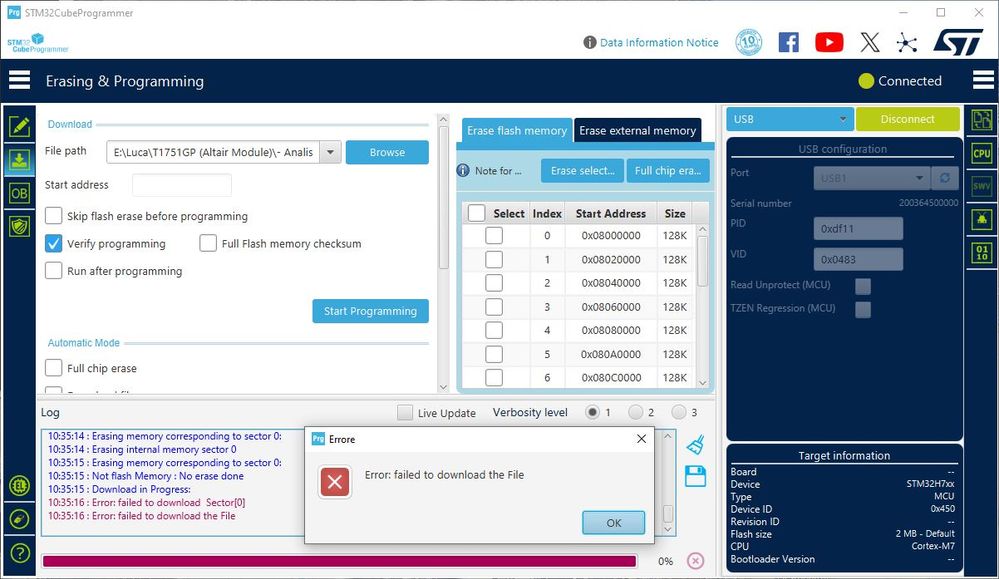

i'm working with a custom design where a STM32H743XIH6 is provided on the board along with an USB connection. I'm actually dealing with an issue on USB firmware programming using STM32CubeProgrammer v2.19.0 (up-to-date, but same issue occur with previous versions).
When downloading firmware the following error occurs:

10:35:16 : Error: failed to download Sector[0]
10:35:16 : Error: failed to download the File
Error: failed to download the fileError: failed to download the file

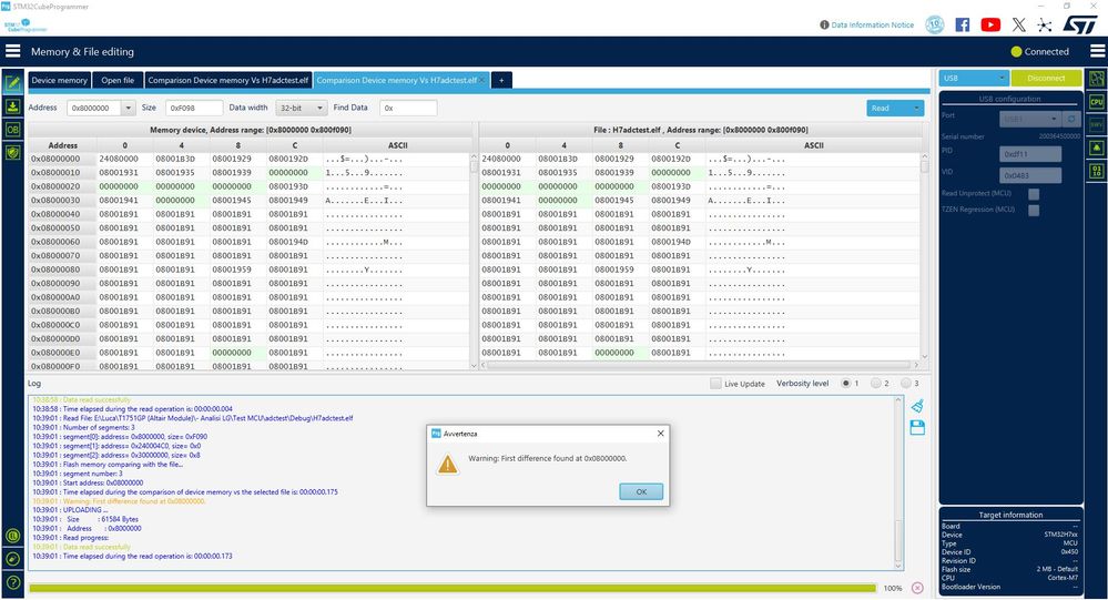

  • When doing "compare memory with file" i got a "Warning: First difference found at 0x8000000" but, I don't see any difference.
Warning: difference foundWarning: difference found

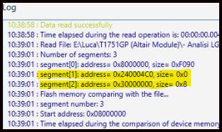

Normally a firmware image for STM32H743 should not contain anything loaded in RAM areas (like your segment[1], segment[2]).  Check the link script.   CubeProgrammer could handle this better: sanitize the image before programming, ignore 0-size segments...

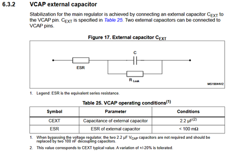

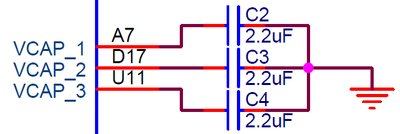

Check voltage and capacitors placed on VCAP pins.
Spaghetto
SpaghettoAuthor
Jul 2, 2025 12:53 PM UTC
Hi Tesla,
according to design:

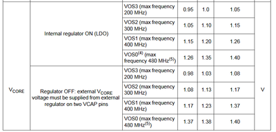

where C2,C3,C4: "CAP 2.2UF 50V X7R 10%" TAIYO YUDEN UMK212BB7225KG-T.
They seems compliant to datasheet, I'm only in doubt with ESR (which installed ones seems mismatch):
I measure a stable 1.01V on all three VCAP pins when in DFU mode, since I use internal regulator it should be ok.
Does it makes sense?

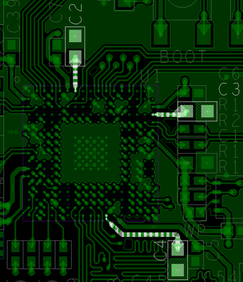

Jul 4, 2025 7:23 AM UTC
Just let me underline that I have no problems downloading the firmware via SWD.
Tried adding 100nF in parallel to those caps but nothing changed, below the layout is shown.
Could anyone suggest me any more test to be performed?
Thanks in advance

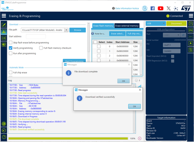

I fully understand segment[2], since I set up the MPU for an external 8MB SDRAM, I don't understand the segment[1] but I related it to the DMA: since on the STM32H743 I'm using ADC via DMA I had to modify the to modify the linker as suggested on this post (section "GCC linkerscript (*.ld file)").
To omit this section in the hex\elf file I was loading into STM32CubeProgrammer I just appended the "NOLOAD" property to the code suggested and everything started working flawlessly (all the segments disappeared in the Log console).
