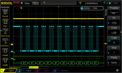

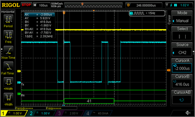

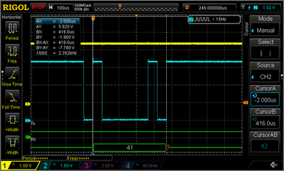

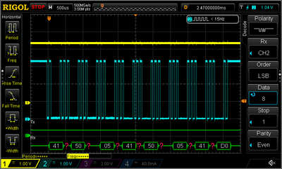

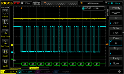

Working! What i did?
In all tests below, I was sending 'A' (0x41) at 115,200
Sending 8N1 - everything works fine:
Sending 8E1 - NOT working:
Data is indeed corrupted.
I changed the Scope settings to None and the data was parsed in the scope OK
So I sent only 1 byte:
Sending 1E8
Both regular sending & DMA received wrong - Parity is missing!
So I changed data length to 9bits - It's working!

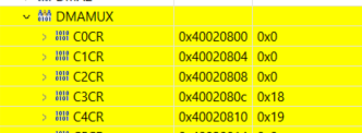

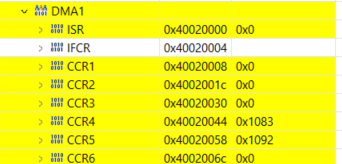

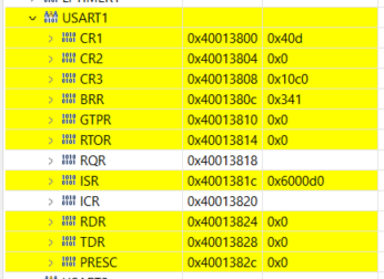

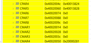

Hey,
I'm not using IOC for configuration.
Registers value, after config, before sending/receiving anything at all.
USART1:
DMAMUX:
All other regs under DMAMUX are 0x0.
DMA1:
All other regs under DMA1 are 0x0.
CMAR4 is indeed the address of my rx_buffer.
2 bytes instead of 3:
dataxxx is global.
uint8_t dataxx[3] = {'A', 'B', 'C'};
UsartSend(dataxx, 3);

waclawek.jan
Registers look good at this point, as well as the Tx code.
You may want to have a look at them and compare after UartSend.
How do you observe the Tx'd data, oscilloscop/logic analyzer, or something else? What's the source for Rx, is it a loopback from Tx?
Isn't there some other code which may interfere, e.g. some RTOS?
What hardware is this, a "known good" board like Nucleo, or your own? In the latter case, can't there be a problem in the hardware, e.g. the Tx pin getting active resulting in power supply dip and subsequent reset?

waclawek.jan
What happens if you try to transmit more than 3 bytes - say, the whole alphabet?
Sending 1E8
waclawek.jan
In the STM32 UART, contrary to the usual convention, parity bit counts towards the total bit number.
In other words, for 8E1, you need to set 9 bits in the STM32 UART.
And yes, I have forgotten about this, too...
