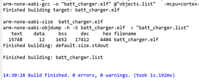

It sounds like you have the EWARM toolchain selected, not STM32CubeIDE.
In the IOC file you provided, STM32CubeIDE is selected. Perhaps you are using some other file.

Can you include the IOC file?
Generally, the "*_template.c" files shouldn't be compiled as-is and aren't included in CubeMX output.
kzsd
If the IDE is deciding to include these files, maybe it's a bug then?
I had no problems generating code and compiling the project from the IOC. The template files mentioned above were not included in the generated files.
Are you copying files manually or something?
kzsd
I haven't changed anything else since my previous IOC file.  How can I exclude these extra files?

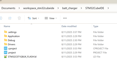

I switched to "Copy only the necessary library files" in the IOC file, which helped. But I think my remaining issues are because the .cproject file doesn't reflect the new MCU. What's the best way to change this?
Delete everything except the IOC and let it regenerate new metafiles. Back up files first. Once that works, copy over source files that you modified.
kzsd
This process does not generate a new .project or .cproject file.
Does for me. Are you looking in the right directory (STM32CubeIDE)?
kzsd
No, I do not see that directory appear after following your steps. It creates folders for Core, Drivers, and EWAM. The top level also has a here is a .mxproject file. Inside EWARM, there is a "project.eww" file but it is not complete at all.
