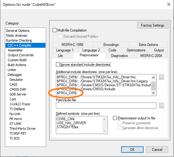

4) In IAR, right click in the workspace to adjust options for node "CubeMXError".
5) In IAR, Pick category C/C++ Compiler and then tab Preprocessor
6) In IAR, Under Additional include directories, add on a line all by itself, $PROJ_DIR$
7) In IAR save the workspace.
8) Go back to STM323CubeMX and generate code again.
Error: The Code is successfully generated under : C:/Users/Public/HgRepos/CubeMXError Project language : C but EWARM V8.32project generation have a problem.

Hi @Community member​ ,
Let me sure that I understand the scenario, the error happens after you add an additional include in Preprocessor Tab?
Can you please give me the exact line added?
