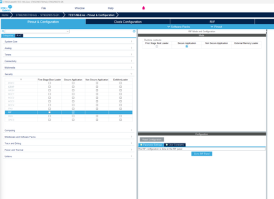

I am using the STM32N6570-DK board and when I generated the project, all lines about RIF demonstrate some errors, it seems that the hal_driver doesn't add the C file about the RIF. I am wondering how I can fix it.

Hello @Z-YF ,
In order to build successfully your project, I suggest that you enable the RIF peripheral on STM32CubeMX then generate the code.
I will be waiting for your feedback.
Thanks.
Mahmoud

I need to know that whether I have already fixed the problem and do the two warnings actually matters?
Hello @Z-YF ,
Thanks.
Mahmoud
Yes, thank you for your time. Now I can successfully use the LTDC and DCMIPP.   :)
