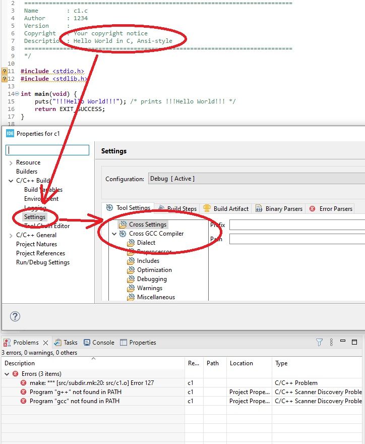

DM-SH
Thanks.
But oooops... I can't find this item. Where is it?
DM-SH
Thanks! It is realy will be useful for me, but at the next step.
I am at this point, with very simlpe test of STM32CubeIDE: only "Hell-O World" as oldschool C. Before MCU, before Discovery.....
DM-SH
...The Tool Chain I have found also. And I don't know, does it need to be changed? :
DM-SH
Perhaps there is a setup guide (as pdf) - from STM ?
There's no "Tool Chain Editor" in CubeIDE. If you don't have CubeIDE, you have some other toolchain, right? Then you know where you installed it.
If you have common Eclipse CDT with Embedded C/C++ add-on, here is the documentation: https://eclipse-embed-cdt.github.io/
