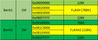

If I would summarize what you have used as Flash:
In yellow what you have used as Flash. My question is:
Are the flash regions that kept unused (in green), is intentional?
If FLASH1 (FLASH) is full you need simply to stretch its size. There is 128K after which is free unless it is used for something else.
Otherwise, to my knowledge, there is no method to let the tool to bond a separated and not contiguous regions (except, I think, IAR..)

This is what you have to take into account (From the datasheet Table 2). The flash size config depends on the device:
For the config 2 x 512k the flash is not contiguous. So you are limited to 512k for each bank and you cannot bond them. For the second case: 2 x 1M: you can use all the 2M without issue. The two "1M" are contiguous.

If you have 2x1M device, you can use all the flash so simply stretch the region Flash1. If it overlaps with Flash2 move it in the next contiguous address.
In my case i have 2x512KB (STM32H743ZGT6) so it's not contiguous. It's possible to use the FLASH2 with this device ?
It's not possible if the flash region you configured in linker file exceeds 512kB.
