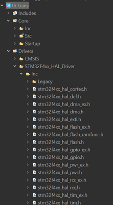

I am trying to compile a STM32 project with my own code structure. I have not changed the structure created by the IDE when creating the project and have added my .c and .h files in the Src and Inc folders in Core directory. But I am getting an error where the compiler is not able to find the include paths. I am attaching the error and screenshots for your reference. I have added the include paths in project settings. Is there something that I am missing?

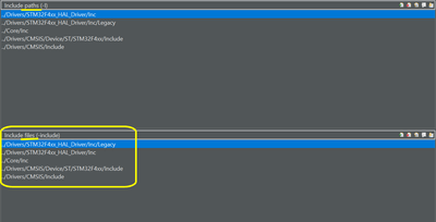

Yes, those are all the include paths in my project. I have attached a txt file which has the console output

Thanks - so these are the actual errors:
<command-line>: fatal error: ../Drivers/STM32F4xx_HAL_Driver/Inc/Legacy: No such file or directory
compilation terminated.
make: *** [Drivers/STM32F4xx_HAL_Driver/Src/subdir.mk:64: Drivers/STM32F4xx_HAL_Driver/Src/stm32f4xx_hal.o] Error 1

They are, in fact, all the same error - they all refer to just one folder, ../Drivers/STM32F4xx_HAL_Driver/Inc/Legacy
Note that this is specified as a relative path.
The trouble with relative paths is that they only work when you start from the right place...

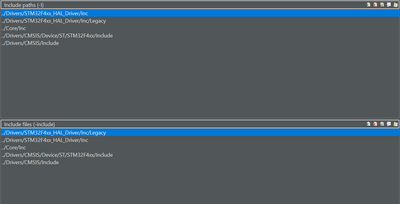

Remove everything in the lower part of the includes dialog : Include files (-include)
Ah yes - that lower section is "Include files":
@ronk123 but the entries you have specified there are not files - they are paths!
Here is the documentation of what -include (ie, that part of the dialog) does:
