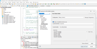

Hi there,
My project has ended up in the same state. As can be seen in the attached screenshot;
* it is stm32cubeide
* it does have the toolchain editor
* it cannot find gcc.exe.
Any advice before I start reinstalling everything from ST?
...For anyone that gets into the same state: somehow or other, the project had been imported to stm32cubeide as a standard eclipse project. Importing it as an stm32cube project brought back full functionality.
