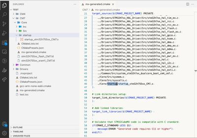

I've generated code for a dual cure MCU (stm32H755) and tried to build the project (on a unix system). However, I get an error in `mx-generated.cmake` indicating that the startup file cannot be found. I tracked down the issue to the directory for the startup `.s` file being in `startup` all lowercase, while the CMake expects `Startup` (capital S).

‎2024-09-16 7:41 AM - edited ‎2024-09-16 8:03 AM
hello @drewhanshaw
I'm not able to reproduce this issue on my side (I don't have a Linux PC now). Could you please. give me more details on how to reproduce that. The .ioc file will help also.
Best Regards.
STTwo-32
‎2024-09-24 8:46 AM
Apologies for the late reply. I was able to recreate the issue by creating a new project for the STM32H7, going to project manager, entering a project name and location, selecting CMake for the toolchain/IDE, and generating the code. The result is a generated Core/startup directory (lowercase s in startup), while the `mx-generated.cmake` uses Core/Startup (capital S in startup). See below:
I've also attached the .ioc here. I'm macOS Sequoia, with cubeMX version 6.12.0

‎2024-09-24 9:14 AM
Hello @drewhanshaw
I've been able to reproduce the issue, and I've reported to the concerned team for correction (under internal ticket number 191993).

‎2024-12-02 1:43 AM
Hello @drewhanshaw
This behavior has been solved on the last version of the STM32CubeMX V6.13.0.
