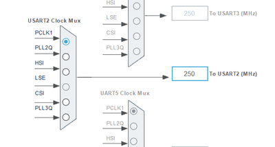

I am using the NUCLEO-H563ZI board and I am trying to configure the UART2 using only registers.
I started by creating a fresh and simple new code with STM32CubeIDE for UART transmit because I wanted to use a simple uart_transmit function but I had trouble making it work until I activated the USB as Host_Only from the .ioc
Pinout & Configuration and only then was I able to use the HAL_UART_Transmit to send a text to a terminal and I would like to know why that is.
Then I want to be able to configure the UART2 directly with the registers but then the code breaks how can I make this work? Thank you.

    RCC->AHB2ENR |= RCC_AHB2ENR_GPIODEN;        // ENABLE GPIO PORT D CLOCK (BIT 0)
    RCC->APB1LENR |= RCC_APB1LENR_USART2EN;       // ENABLE UART2 CLOCK (BIT 14)
    GPIOD->MODER &= ~((3u << 10)    // CLEAR PD5
                     |(3u << 12));  // CLEAR PD6
    // SET PIN MODES
    GPIOD->MODER |= ((2u << 10)     // SET PD5 TO AF
                    |(2u << 12));   // SET PD6 TO AF
    GPIOD->AFR[2] &= ~((15u << 20)       // CLEAR PD5 AF
                      |(15u << 24));     // CLEAR PD6 AF
    // SET ALTERNATE FUNCTION
    GPIOD->AFR[2] |= ((7u << 20)         // SET PD5 AF
                     |(7u << 24));       // SET PD6 AF
    USART2->CR1 &= ~(USART_CR1_M1       // CLEAR M1 FOR 1 START BIT AND 8 DATA BITS (28)
                    |(0x03 << 26)       // INHIBIT INTERRUPTS AT BITS 26 AND 27     (27/26)
                    |USART_CR1_OVER8    // OVERSAMPLING BY 16                       (15)
                    |USART_CR1_CMIE     // INHIBIT CHARACTER MATCH INTERRUPT        (14)
                    |USART_CR1_MME      // DON'T ENABLE MUTE MODE                   (13)
                    |USART_CR1_M0       // CLEAR M0 FOR 1 START BIT AND 8 DATA BITS (12)
                    |USART_CR1_PCE      // NOT IMPLEMENTING PARITY CONTROL          (10)
                    |(0x1F << 3)        // INHIBIT INTERRUPTS AT BITS 4 TO 8        (4-8)
                    |USART_CR1_TE       // DON'T ENABLE TRANSMITTER JUST YET        (3)
                    |USART_CR1_RE       // DON'T ENABLE RECEIVER JUST YET           (2)
                    |USART_CR1_UE);     // DON'T ENABLE UART2 JUST YET              (0)
    // CONFIGURE USART CR2 REGISTER
    // CLEAR BITS
    USART2->CR2 &= ~(USART_CR2_RTOEN    // DISABLE RECEIVER TIMEOUT             (23)
                    |USART_CR2_ABREN    // NO AUTOMATIC BAUD RATE DETECTION     (20)
                    |USART_CR2_MSBFIRST // TRANSMIT/RECEIVE LSB FIRST           (19)
                    |(0x03 << 16)       // IDLE STATE HIGH FOR RX/TX PINS       (17/16)
                    |USART_CR2_SWAP     // DON'T SWAP FUNCTION OF RX/TX PINS    (15)
                    |USART_CR2_LINEN    // NO LIN MODE                          (14)
                    |(0x03 << 12)       // 1 STOP BIT                           (13/12)
                    |USART_CR2_CLKEN    // DON'T USE CLOCK WITH UART            (11)
                    |USART_CR2_LBDIE);  // NO LIN BREAK DETECTION INTERRUPT     (6)
    // CONFIGURE USART CR3 REGISTER
    // CLEAR BITS
    USART2->CR3 &= ~(USART_CR3_TCBGTIE  // NO TRANSMISSION COMPLETE BEFORE GUART TIME INTERRUPT (24)
                    |USART_CR3_DEM      // NO DRIVER ENABLE MODE                                (14)
                    |(0x7F << 3)        // DISABLE VARIOUS IRRELEVANT MODES                     (9-3)
                    |USART_CR3_IREN     // NO IrDA MODE                                         (1)
                    |USART_CR3_EIE);    // INHIBIT ERROR INTERRUPT                              (0)
    // SET BITS
    USART2->CR3 |= (USART_CR3_OVRDIS    // DISABLE OVERRUN FUNCTIONALITY (12)
                   |USART_CR3_ONEBIT);  // USE ONE SAMPLE BIT METHOD     (11)
    // SET BAUD RATE IN BRR REGISTER
    USART2->BRR = 2170;
    // VALUE THAT SETS BAUD RATE TO 115,200 AT INPUT FREQUENCY OF 4MHZ
    // ENABLE UART
    USART2->CR1 |= (USART_CR1_TE        // ENABLE TRANSMITTER (3)
                   |USART_CR1_RE        // ENABLE RECEIVER    (2)
                   |USART_CR1_UE);      // ENABLE UART2       (0)
	USART2->CR1 = 0x00;   // Clear ALL
	USART2->CR1 |= (1<<13);   // UE = 1... Enable USART
	USART2->BRR = 2170;   // Baud rate of 115200, PCLK1 at 45MHz
	USART2->CR1 |= (1<<2); // RE=1.. Enable the Receiver
	USART2->CR1 |= (1<<3);

gbm
Principal
There is no AFR[2] register. The bits you want to set are in AFR[0].
Don't do logic operations on USART CRx registers. Simply write the proper values to them. For basic setup. you only need to set BRR and CR1 - two assignments are enough.
My STM32 stuff on github - compact USB device stack and more: https://github.com/gbm-ii/gbmUSBdevice
Thank you but it still doesn't work
static void MX_USART2_UART_Init(void)
  /* USER CODE BEGIN USART2_Init 0 */
    // SET PIN MODES
    GPIOD->AFR[0] &= ~((15u << 20)       // CLEAR PD5 AF
    GPIOD->AFR[0] |= ((7u << 20)         // SET PD5 AF

also I see the clock config for the UART2 and it's 250MHz from the PCLK1, should I change that?
