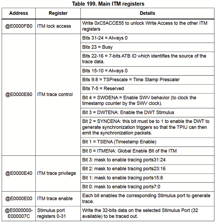

I'm attempting to follow https://community.st.com/t5/stm32-mcus/using-the-itm-console-for-printf-redirects-and-lwip-debug/tac-p/850072/highlight/true#M1661 but this always fails. This is on an STM32F303K8T. My reference manual says
and offers an example:
    "To output a simple value to the TPIU:
• Configure the TPIU and assign TRACE I/Os by configuring the DBGMCU_CR (refer to
Section 33.17.2: TRACE pin assignment and Section 33.16.3: Debug MCU
configuration register)
• Write 0xC5ACCE55 to the ITM Lock Access Register to unlock the write access to the
ITM registers
• Write 0x00010005 to the ITM Trace Control Register to enable the ITM with Sync
enabled and an ATB ID different from 0x00
• Write 0x1 to the ITM Trace Enable Register to enable the Stimulus Port 0
• Write 0x1 to the ITM Trace Privilege Register to unmask stimulus ports 7:0
• Write the value to output in the Stimulus Port Register 0: this can be done by software
(using a printf function)"

I have written:
// Number of ITM ports (defined by the ARM standard)
static const size_t N_PORTS = 32u;
bool logi_enable_itm(void) {
    // Follow along with 33.14.2 'Example of configuration'
    // 1. Configure the TPIU and assign TRACE I/Os by configuring the DBGMCU_CR
    // Done by the debugger host (i.e. Cube).
    // 2. Write 0xC5ACCE55 to the ITM Lock Access Register to unlock the write access to the
    // ITM registers
    ITM->LAR = 0xC5ACCE55u;
    // 3. Write to the ITM Trace Control Register to enable the ITM
    ITM->TCR = ITM_TCR_ITMENA_Msk;
    // 4. Write to the ITM Trace Enable Register to enable the Stimulus Ports
    ITM->TER = 0b111111u;
    // 5. Write 0x1 to the ITM Trace Privilege Register to unmask stimulus ports 7:0
    ITM->TPR = 1u;
    // (not documented)
    // ITM->LAR = 0u;
    return true;
static bool ITM_SendCharTo(uint8_t ch, uint8_t port) {
    if (port >= N_PORTS)
    	return false;
    const uint32_t
        tcr = ITM->TCR & ITM_TCR_ITMENA_Msk,  // ITM enabled
        ter = ITM->TER & (1u << port);        // port enabled
    if (!(tcr && ter))
        return false;
    while (ITM->PORT[port].u32 == 0u)
        __NOP();
    ITM->PORT[port].u8 = ch;
    return true;
but this always hangs on the NOP loop. I've also tried changing the ITM_TCR_TraceBusID and enabling SYNC, to no avail.
What could be happening here?

avidroneg
Right after posting this, I found that STCube's SWV ITM Data Console needed to have Start Trace enabled for the loop to unblock, which I guess is what is implied by the SYNC feature. That's fine for debugging I guess, but this seems like a non-starter for production when the debugger is not connected.
