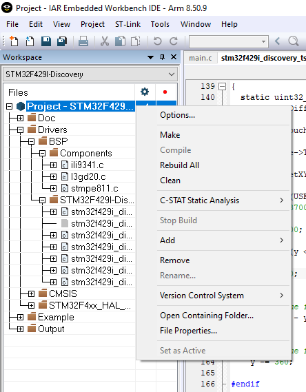

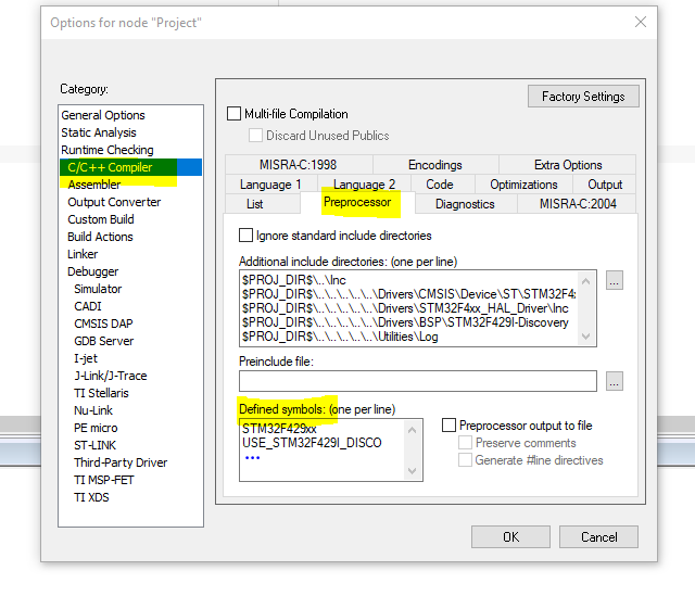

‎2023-05-08 7:02 AM - edited ‎2023-11-20 8:11 AM
Hello @AIann.3​
Could you please provide me which IDE are you using?
if you are using EWAR ( IAR), the stpes below helps you to add USE_STM32F429I_DISCOVERY_REVD" define in the toolchain's pre-processor options:
1/ click right button on your project as screenshot below 2/ choose c/c++ Compiler , Then click on the Preprocessor : in the block
defined symbols add your define
